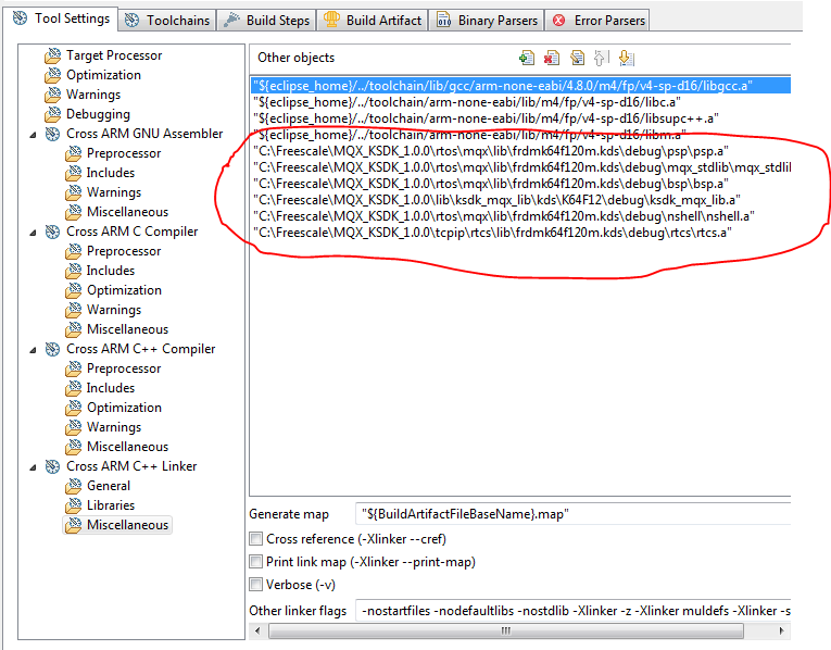

I've been trying to figure out how to take a bare-bones MQX/KSDK/PEx project and add RTCS to it.  I feel like I'm getting close as I muddle through it, but now I'm at a point where I don't think I can do anything to solve my error.
This is the error that KDS is giving me:
Description    Resource    Path    Location    Type
make: *** missing separator.  Stop.    objects.mk    /RemotePowerControl/Debug    line 6    C/C++ Problem
This is what I've added to my linker options to link to the necessary libraries:
and the resulting object.mk that gets created:
################################################################################ # Automatically-generated file. Do not edit! ################################################################################  USER_OBJS := C:/Freescale/KDS_1.1.1/eclipse//../toolchain/lib/gcc/arm-none-eabi/4.8.0/m4/fp/v4-sp-d16/libgcc.a C:/Freescale/KDS_1.1.1/eclipse//../toolchain/arm-none-eabi/lib/m4/fp/v4-sp-d16/libc.a C:/Freescale/KDS_1.1.1/eclipse//../toolchain/arm-none-eabi/lib/m4/fp/v4-sp-d16/libsupc++.a C:/Freescale/KDS_1.1.1/eclipse//../toolchain/arm-none-eabi/lib/m4/fp/v4-sp-d16/libm.a C:/Freescale/MQX_KSDK_1.0.0/rtos/mqx/lib/frdmk64f120m.kds/debug/psp/psp.a  C:/Freescale/MQX_KSDK_1.0.0/rtos/mqx/lib/frdmk64f120m.kds/debug/mqx_stdlib/mqx_stdlib.a C:/Freescale/MQX_KSDK_1.0.0/rtos/mqx/lib/frdmk64f120m.kds/debug/bsp/bsp.a C:/Freescale/MQX_KSDK_1.0.0/lib/ksdk_mqx_lib/kds/K64F12/debug/ksdk_mqx_lib.a  C:/Freescale/MQX_KSDK_1.0.0/rtos/mqx/lib/frdmk64f120m.kds/debug/nshell/nshell.a C:/Freescale/MQX_KSDK_1.0.0/tcpip/rtcs/lib/frdmk64f120m.kds/debug/rtcs/rtcs.a  LIBS :=
It doesn't seem to like the newline on line 6 above.
What can I do to fix the objects.mk that is used, if it's just going to get overwritten anyway?

Hi Alice, thanks for your reply.  I've gone through that user's guide walkthrough before.  I've also used the ones found on this forum.  There's a bit of confusion about the value of KSDK_PATH.  I have mine set to C:\Freescale\MQX_KSD_1.0.0, rather than what the doc has listed, which is the KSDK_1.1.1 folder.
My goal is to have a basic MQX/PEx project that I can then add RTCS to.  What I did here was start with the MQX/PEx portion and confirm that the wizard-generated code worked (and it did).  Then I #included rtcs.h and added the libraries that I believe are necessary to support ethernet in my project.
Here's my project archive.  It has a compiler error as well that I don't recall seeing before.  If you wouldn't mind taking a peek at it, I would appreciate it!

No, I mean that when I add the .a files to the linker settings, I get the objects.mk error.  Thanks for suggesting looking at the rtcs examples, but the only thing I got from that was that I might need one other lib, but it doesn't look different other than that (and it's using the C linker, whereas I am using C++ linker).
