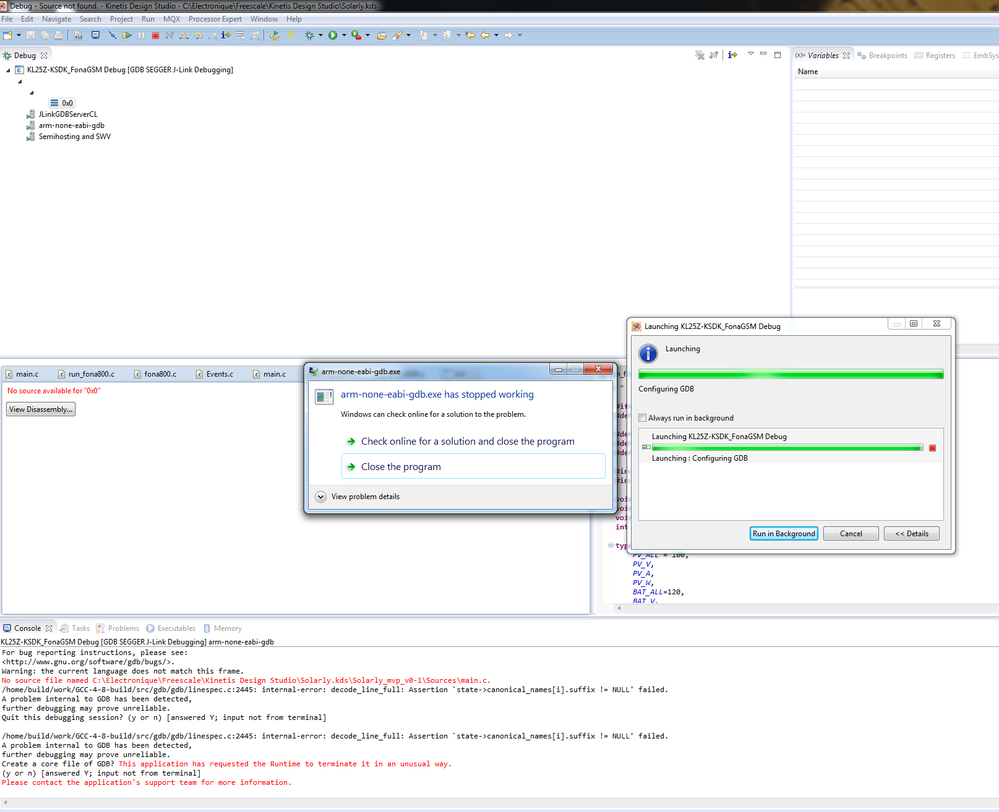

Ok so, I just got a weird crash with gdb server today. I don't know the reason yet, it just happened like that ...
I tried :
- Restart KDS
- Reboot Windows
- Unplug/replug, SEGGER J-Link
Still crashing ... I can compile but it is not possible to launch debug.
I attach a screenshot where you can see the window crash  :
Below it is problem details :

Hi Maxime,
try deleting all breakpoints, see https://mcuoneclipse.com/2014/10/11/failed-to-debug-with-gdb-breakpoints-or-expressions-on-non-exist...
I hope this helps,
Erich

Ok, I deleted all breakpoints and now it work again.
Thank you Erich for your help.
