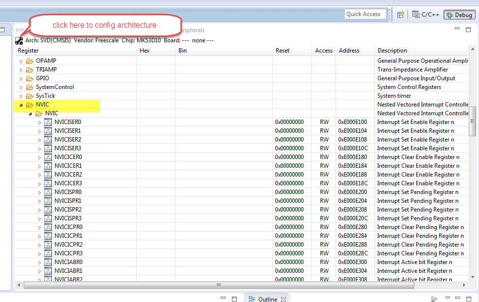

ZhangJennie
Nested Vectored Interrupt Controller( NVIC) is ARM register.
you can find the definition in attached document. search the doc with keyword "NVIC" you will know.
if you use KDS3.0, you can also view NVIC in debugger:
can this help?

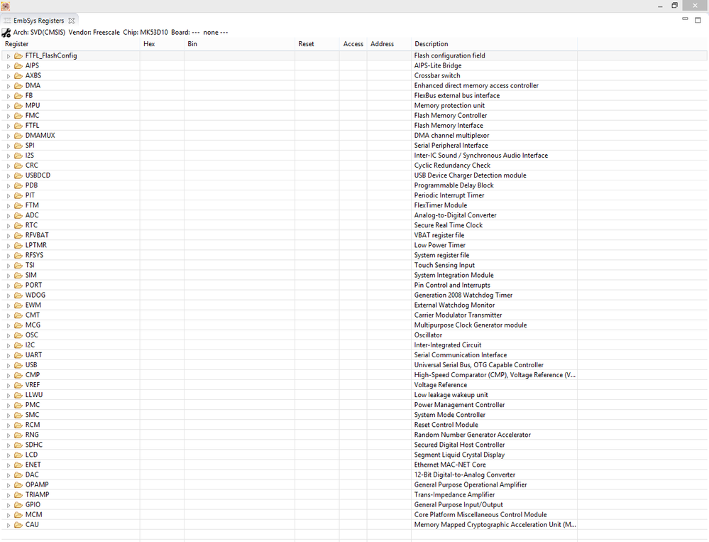

thanks for your answer! But that is the problem. Look at my embsys table:
Its missing and I dont know why :smileysad:

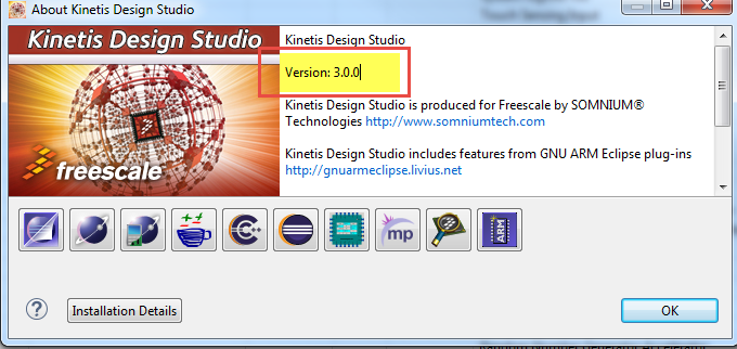

ZhangJennie
hi
1. are you sure your KDS version is 3.0. please check
is your side the same as below?
please make sure you use the latest version
Kinetis Design Studio Integrated Development |Freescale

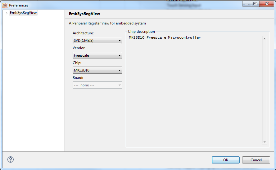

2. did you do the same setting as below?

ZhangJennie
In Eclipse, use the menu Help > Install New Software and use the following update site:
http://embsysregview.sourceforge.net/update
EmbSysRegView Update from Eclipse
Zhang Jun
