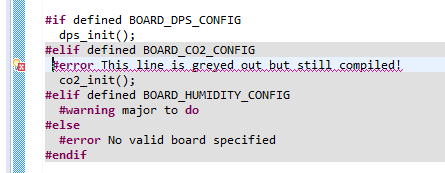

I have a pre-processor if/else statement and which text is greyed out doesn't seem to change based upon my project options.
E.g.
#if defined HIGH_POWER_BOARD
 some_function();
#elif defined LOW_POWER_BOARD
  another_function();
#else
 #error Board Type needs defining
#endif
In my project options I have two configurations defined ( Project /Properties / C/C++ Build / Configuration ) - High Power Config & Low Power Config.
In defined symbols I have (Project /Properties / C/C++ Build / Settings / Tool Settings / Cross ARM C Compiler / Preprocessor / Defined Symbols ) I have defined HIGH_POWER_BOARD for High Power Config and LOW_POWER_BOARD. for Low Power Config.
When High Power Config is active 2nd & 3rd blocks above are greyed out and the 1st block of code is the code that's compiled.
So when I have the Low Power Config active I'd expect the 1st & 3rd blocks above to be greyed out with the 2nd block compiled. The 2nd block (another_function()) is the code that's compiled and active, however it's still the 2nd and 3rd block that's greyed out.
Basically the correct code is compiled/included however the incorrect code is greyed out.
I've attached a screenshot below showing an example from my code.

Hi Ben,
Eclipse uses the Index data base for this (it is a kind of data base). It could be that your database is not correct. And I recommend that you turn off heuristics. Have a read at Fixing the Eclipse Index | MCU on Eclipse  .
I hope this helps,
Erich

beng_
That's worked thanks
