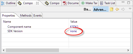

Hi Erich, I downloaded the project and I saw you used KSDK on your project. Is it essential?
Also, I'm a little bit confused: do I have to use SychroMaster methods myself directly or it is used by the FAT_FileSystem under its functions without me noticing it?

Hi Vitor,
No, it is not using the Kinetis SDK, as the version is set to 'none':
That component is only there to make the bridge for either 'none', SDK v1.3 or SDK v2.0 and to provide the necessary wrappers.
As you should see with the example, you do not need to use the Synchromaster methods directly: simply use the FatFS functions.
