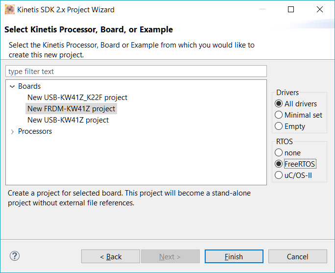

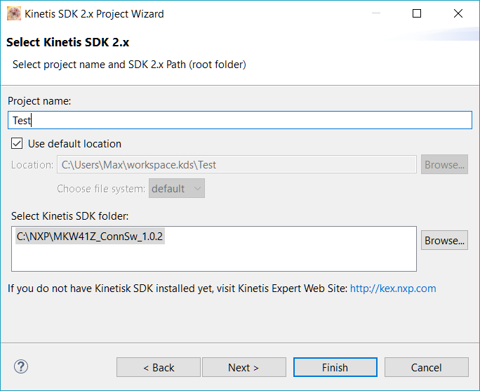

There's a problem with using C++ and KDS 3.2.0 and the provided device drivers on an FRDM-KW41Z kit.
If I create a new project using the Kinetis SDK 2.x Project wizard:
Now, if I replace the contents of main.c with those from the gpio_input_interrupt_frdmkw41z example:

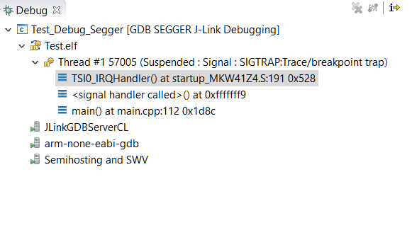

If I then rename main.c to main.cpp and recompile, everything builds fine.
However, when I then debug the program and press SW3 on the FRDM-KW41Z board, it always jumps to the wrong interrupt handler (which is by default an endless loop):
I'm not sure why this is the case, but this isn't something I would have expected.
If I build and run the program as main.c, everything works correctly.
I've attached a ZIP file with the example project. Basically it's gpio_input_interrupt_frdmkw41z but using C++ to build it instead of C.
This problem makes it effectively impossible to use C++ instead of C, since the only difference in builds is the compiler involved!

Hello Max,
Sorry for i haven't this board , so i can not test your project.
I test a simple project include interrupt on other kenitis chip, only change the name main.c to main.cpp,
 it can work well.
Could you please test a bare board project , without RTOS .
if still can not work, please add the below code  in the interrupt function :
#ifdef __cplusplus
extern "C" {
#endif
    " interrupt function "
#ifdef __cplusplus
} /* extern "C" */
#endif‍‍‍‍‍‍
 or
extern "C" {
             "interrupt function"
}  /* extern "C" */
Alice

Hi Alice,
Thanks for the suggestion, it worked.
I guess it would be good for future versions of the Kinetis SDK to make sure that all interrupt handlers are wrapped to use C linkage.
