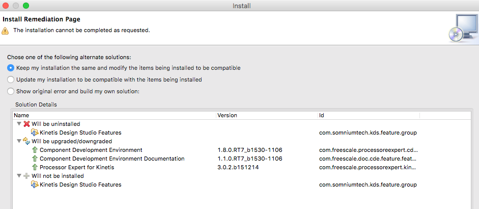

Any ideas? I followed Erich's directions on the 12-22 post .

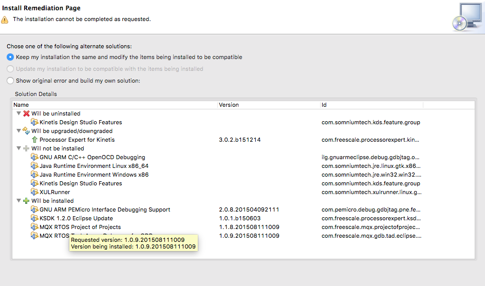

I also reinstalled, fixed the OSX splash screen bug, and tried to update from the archive. Similar errors:

Hi Kenny,
why don't you install KDS 3.2?
Kinetis Design Studio Integrated Development Envir|NXP
It is definitely more stable.
Michal

Hi Kenny,
I've a Mac and I met some problems to install the V3.1 update.
Running the Install New Software I got some problems (Error message)
At then end I was able to install the update following this process:
    - select Help + Installation Details,
    - select Kinetis Design Studio which displayed 3.0 and click on update,
    - then the V3.1 update was installed and now the system displays V3.1.
Pascal
