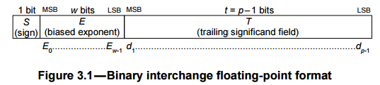

Apologies for the delay, the behavior you see of the lost of precision in your double variable happens because not all 64 bits of your integer number fit on the significant field (52 bits) of your double precision floating-point variable.
The representations of floating-point variables are encoded in the following three fields:

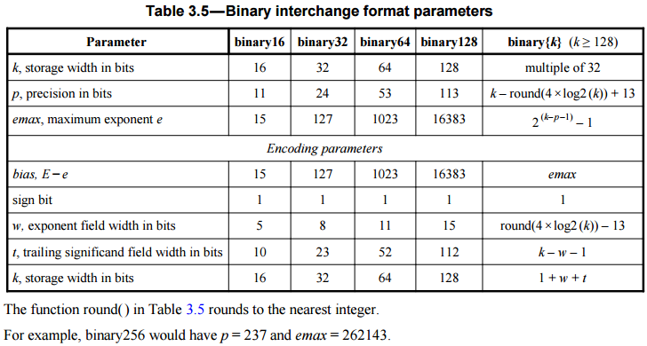

The values of k, p, t, w, and bias for binary interchange formats are listed on the following table:
You can find more information on the following link:

In the example I gave with 0x3E 3C E7 B6 97 E0 10 B6, the binary representation is 64 bits long:
00111110 00111100 11100111 10110110 10010111 11100000 00010000 10110110
Where,
The sign is 1 bit long:
0
The exponent (w) is 11 bits long (995 decimal, below the maximum of 1023):
01111100011
And the significand (t) is indeed 52 bits long:
1100111001111011011010010111111000000001000010110110
As far as I can tell, this is a completely valid double precision value according to the references you provided. An online converter here confirms:
http://www.binaryconvert.com/result_double.html?hexadecimal=3E3CE7B697E010B6
Interestingly enough, if you plug the truncated value 0x3e3ce7b697e01000 into this converter, it generates a number very close to the 6.72999…E-9 shown above. But the KDS debugger (GDB PEMicro Interface) shows 4.4847141003722793e+018. You should be able to replicate this very easily with the project I provided.
If, as it appears, the fields are indeed the correct length and within range, why does the debugger show such a different value?
