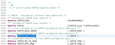

  2. The next failure came literally after a line from an assert fail because the fsl_uart.c wasn't able to find my UART0 macro (defined in fsl_uart.h) in their list of available UARTs!
    Basically the assert failed since it couldn't find the UART0 memory address from the array of supported UART memory addresses named as s_uartBases. And here's the culprit:
    UART0 isn't a part of this list! Any thoughts on this?
    1. I know UART0 is different from UART1 and UART2 in that for UART0 you need to do some additional configurations in the MCU (enable the UART0 clock, specify what clock should be driving this peripheral, etc) that are not needed for UART1 and UART2. So is there another special function to initialize this UART0?
    2. Would it be safe to add UART0 to be a part of this array UART_BASE_PTRS?
I know I can do away with this problem by configuring UART1/2 instead and forget about it. But I'm curious to know if there's something to know here for UART0? Maybe it's something I missed in the Reference Manual?

I'm currently working on your case and I would like to review the project you share with me, however, I'm not able to see through:
UART_WriteByte(); and DB_PRINT();
I want to review the uart write byte function specially.
Regarding your questions:
The UART0 is defined aside the other uart instances on the MKL25Z4.h file.
Also, according to the schematic of the FRDM-KL25Z, using the UART2 to print on the terminal should not be possible since the UART0 instance is the one connected to the K20 OpenSDA interface on the FRDM-KL25Z, I would like to review completely the project and try out my self your configuration to verify my understanding.
I would like to recommend you to update the MCUXpresso IDE version, right now the newer version is the 11.8 and the FRDM-KL25Z's SDK currently is on the 2.2 version, we recommend to use the newer versions since they come with some bug fixes.
