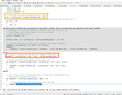

  1. I had the MCU running at default System Clock set up at 48MHz and read from this post that found from the documentation that bus clock is System Clock/2 (he's referring to page 211 of the Reference Manual I think). So that meant that the default UART0 clock value was 24MHz (however, the actual clock value read from Debugger was 21MHz). Anyhow I had put baudrate as 115200 and called the UART_Init function. Here I was getting the error kStatus_UART_BaudrateNotSupport since I was crossing the 3% margin between desired and actual baudrate values. This was because the FW was calculating the below SBR value (see in yellow) as 11.39
    Because of having SBR value as 11 (truncating the decimals), the actual baudrate exceeded the 3% margin (see red box). Is this okay or an expected behavior?
    Me reducing the System Clock to 24MHz - hence reducing bus clock for UART0 to 12MHz - apparently resolved the issue? Thoughts?

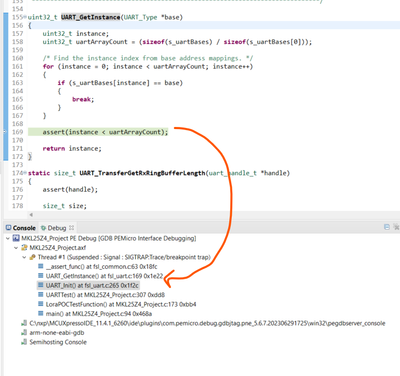

  2. The next failure came literally after a line from an assert fail because the fsl_uart.c wasn't able to find my UART0 macro (defined in fsl_uart.h) in their list of available UARTs!
    Basically the assert failed since it couldn't find the UART0 memory address from the array of supported UART memory addresses named as s_uartBases. And here's the culprit:

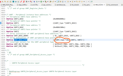

    UART0 isn't a part of this list! Any thoughts on this?
    1. I know UART0 is different from UART1 and UART2 in that for UART0 you need to do some additional configurations in the MCU (enable the UART0 clock, specify what clock should be driving this peripheral, etc) that are not needed for UART1 and UART2. So is there another special function to initialize this UART0?
    2. Would it be safe to add UART0 to be a part of this array UART_BASE_PTRS?

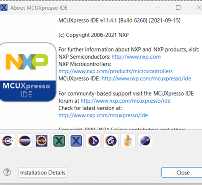

1. Are you using MCUXpresso IDE? Which version?

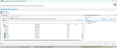

2. Which version of the SDK are you using? And your project is based on an example or are you using only the drivers?

1. Yes I am using MCUXpresso IDE.version 11.4.1
2. For the SDK version I see that I'm using 2.1.4 for UART driver. Hope this is what you are asking.

The UART0 is defined aside the other uart instances on the MKL25Z4.h file.
