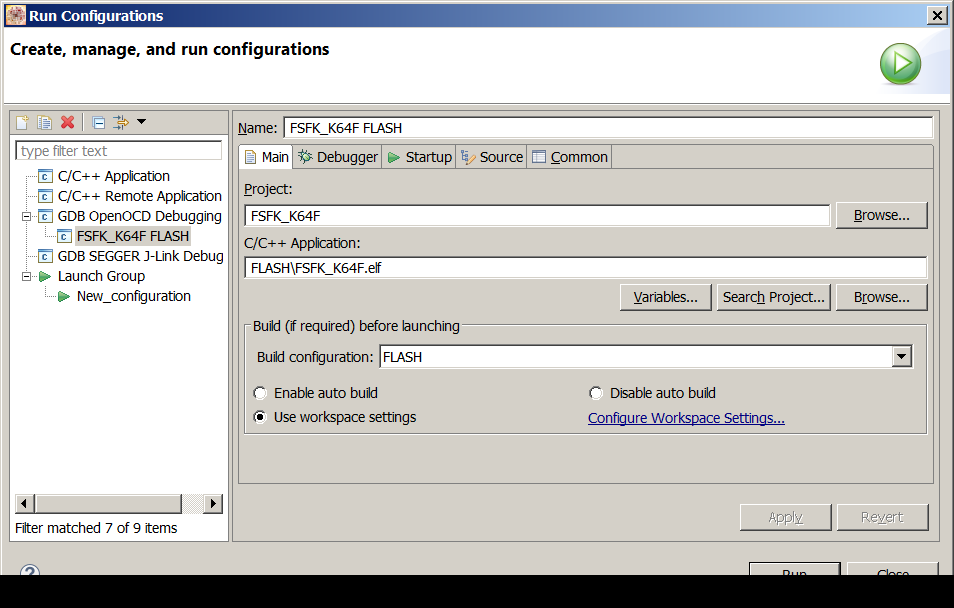

All,
I've updated my Windows 7 machine with KDS3.0 and installed all suggested updates.  I've programmed my K64F board with the most recent CMSIS-DAP software from freescale.com/opensda.
Looking at my K64F board, DETAILS.TXT contains:
Version: 0221
Build:   Jan  7 2015 02:30:03
Git Commit SHA: 5dfa9f6b95b105e2c88258ca9ffe5b7ff8d55e27
Git Local mods: Yes
When I look at run configurations within KDS, I get:

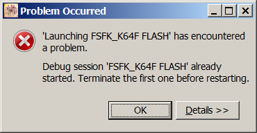

When I hit "Run", I get

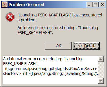

Followed by:
If I try again, I get:
And then I have to close KDS and restart to try again (to no avail).
I've messed with this for hours today.  Can anyone offer suggestions?  Or is it a myth that KDS3.0 offers debug support via CMSIS-DAP?

Hi Mike,
yes, KDS supports OpenOCD with CMSIS-DAP debugging. But it is less easy to use compared to OpenSDA with P&E or Segger J-Link. Unless you have a special reason to use CMSIS-DAP, I recommend P&E or Segger firmware.
One usual roadblock with mbed/OpenOCD/CMSIS-DAP is that you need the mbed serial drivers installed.
Windows serial configuration - Handbook | mbed
Next thing is that you need to make sure that the latest CMSIS-DAP mbed firmware is loaded, see Firmware FRDM K64F - Handbook | mbed
The other thing is that you might need to power cycle the board so the board firmware can properly initialize it.
Last but not least: in case you have a zombie debug process running, kill it: GDB Client and Server: Unlocking GDB | MCU on Eclipse
