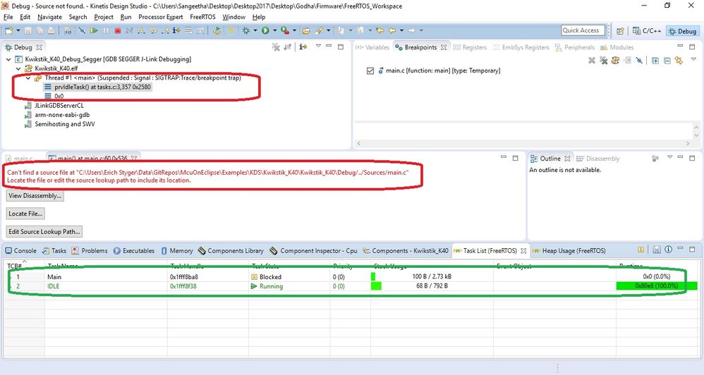

Besides, I got few questions related to that. Image is attached.
1. I could see only main() thread, not the idle thread as it appearing in your image.
2. Keep getting an error saying that "Can't find the source file at "path...".
3. How can I make this component as my default one for all new projects?

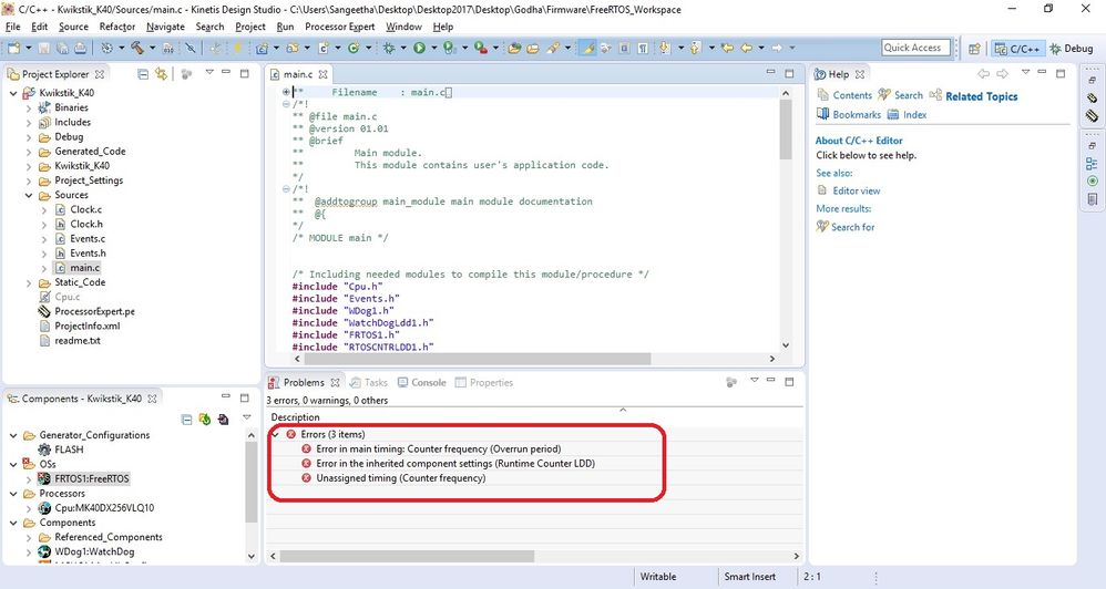

Later, I tried running few times and I ended up in the error as shown in the second image.
Please help me in this regard.

Error appeared later:

1) is probably because you are using an outdated version of the Segger drivers/libraries. See Updating Segger Tools in Eclipse Kinetis Design Studio | MCU on Eclipse  how to update them.
2) make sure you have cleaned your project (Project > Clean) after an import.
3) not sure what you mean with 'default', but you can always use that FreeRTOS component. But you cannot replace the built-in ones.
As a general advise, have a read at Better FreeRTOS Debugging in Eclipse | MCU on Eclipse
