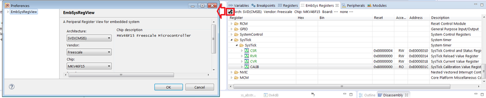

You can use the EmbSys Registers window to see the content of all registers. You just must select the target device manually.
Open the EmbSys Registers window and open the Preferences dialog, see below:
In the dialog select the SVD(CMSIS) architecture, Freescale vendor and the target chip. Click on OK.
All registers will be displayed. You just must select registers which value you want to update (double click on the register). If the content is not updated execute a single instruction by a debugger to refresh the content of the selected registers.
Please note, that you can have a bug in the application (content of registers is overwritten by using uninitialized pointer), heap or stack size issue (memory is overwritten) and so on.

Thanks, but I fear it is simply missing from my view of my K22F MCU. :smileysad: Perhaps some kind soul knows how to update the definition file to include it?
5,118 Views
marek_neuzil
I have checked all MK22F derivatives in EmbSys Registers window (KDS 3.0.0 installation) and all these derivatives contain SysTick registers.
If you are not using KDS 3.0.0 you can try to update EmbSys Registers SVD files, see the detailed description on the webpage Updated Eclipse EmbSysReg Viewer with extra Freescale SVD Files | MCU on Eclipse
Marek Neuzil
5,118 Views
tharonhall
Yeah! There is an even better file for my device now and with the update I can see SysTick. Now the question is whether or not I can fix my issue, though the good news is I am better prepared to debug it. :smileyhappy:
