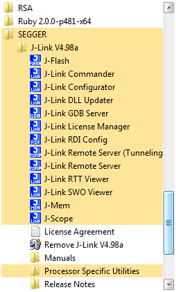

BlackNight
Segger has many other means to access the data in realtime, see
https://www.segger.com/j-link-j-scope.html
https://www.segger.com/j-link-swo-viewer.html
SEGGER - The Embedded Experts - World’s first real time terminal with SEGGER J-Link
Which all are possible to be used in combination with KDS.
Erich

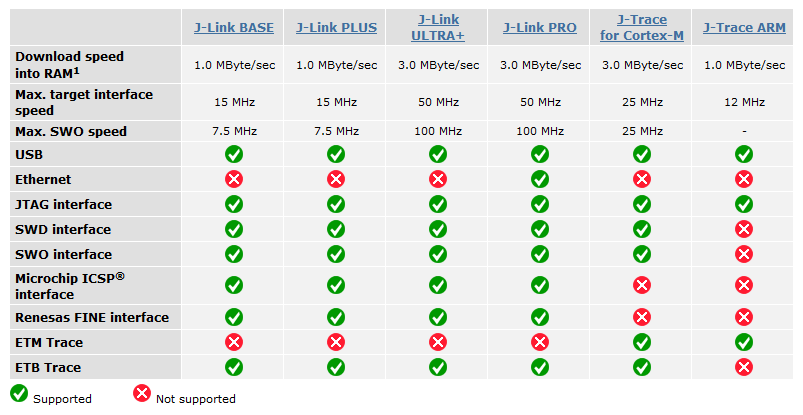

Dear kornwut chalermmeekol,
As Jorge mentioned, you can watch variables via expression view in KDS, but you must stop the program. It is not real-time routine.
The differences between J-Trace and J-Link is that J-Trace periodically halt cpu and read data from registers.
Here are the main differences, while ETM Trace is shortcut for Embedded Trace Macrocell, CoreSight Trace Macrocells - ARM
and ETB is shortcut for Embedded Trace Buffer, small, circular on-chip memory area where trace information is stored
during capture. It contains the data which is normally exported immediately after it has been captured from the ETM.
There are a lot of these tools, which you can use for the watching variables for J-Link.
Another one is e.g. J-Mem Memory Viewer, but it is for J-link too, because you must always stop the program
You can also use J-scope, it is something like Freemaster for J-link is a free-of-charge software to analyze and visualize data on a microcontroller in real-time, while the target is running.
You just choose target device, target interface and speed and its elf file.
https://www.segger.com/cms/admin/uploads/imageBox/JScope.png
SEGGER - The Embedded Experts - J-Scope
