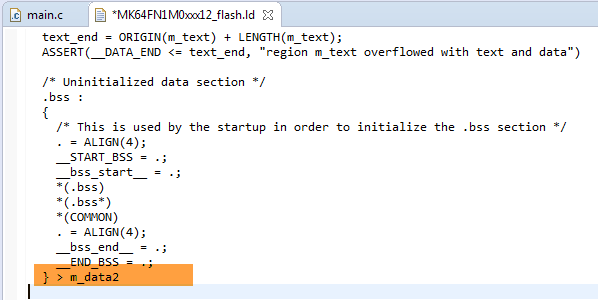

hi Sylvain,
I just copied your code in one of K64 KSDK project, I can reproduce your problem.
you defined
uint16_t data_current_raw[MEASURES_MAX][BUFLEN] = {{0}};
static uint16_t meas_data_all[MEASURES_MAX][BUFLEN] = {{0}};
each of the size is 170*128*2=43520 , so two arrays use 43520*2=87040 bytes code size .
both of these arrays are distributed to .bss section.
in linker file(under C:\Freescale\KSDK_1.3.0\platform\devices\MK64F12\linker\gcc), there are two data areas:
and .bss section is allocated to m_data which total size is 65535 bytes
if we allocate larger memory to .bss. this can solve the problem. here I allocate .bss to m_data2 which has 196608 bytes size, .bss can hold the arrays.
then i built the project again. there is no error.
can you please try the same?
can this help you?
Zhang Jun

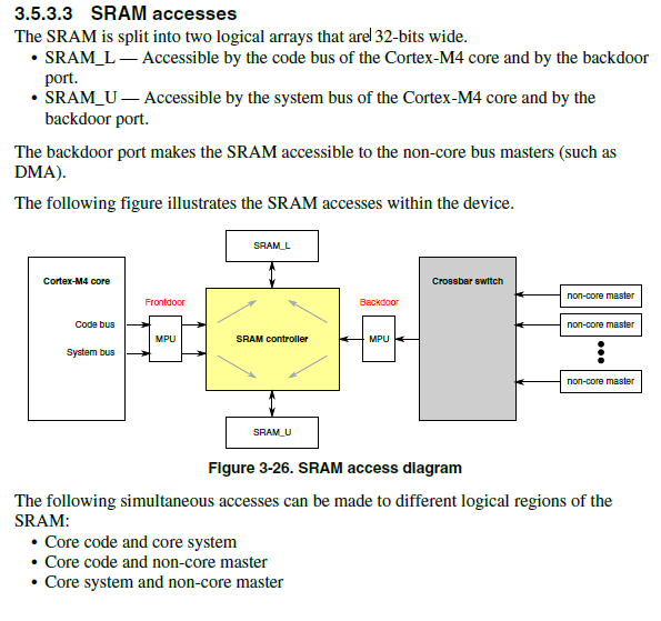

In the meantime can you tell me why the RAM is cut in two part with respectively 25% and 75% of the memory?
What if I want to make use of the full 256KB of RAM?

Hi Sylvain,
we can refer K64 reference manual for why SRAM is separated into two parts.
becuase SRAM_L and SRAM_U are accessible by different bus.  in some low power mode, for example VLLS2 (Very Low Leakage Stop2), SRAM_L is powered off. A portion of SRAM_U remains powered on.
if your project uses SRAM_L and SRAM_U in same way, I think you can use them together.

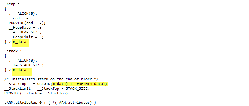

for example in ld file, we define m_data as
  m_data            (RW)  : ORIGIN = 0x1FFF0000, LENGTH = 0x00040000
/*  m_data_2
(RW)  : ORIGIN = 0x20000000, LENGTH = 0x00030000 */
then don't forget allocate related stack and heap to m_data too
after build, there is no error. in map file. we can see meas_data_all and and data_current_raw succesfully allocated.
