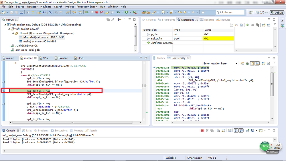

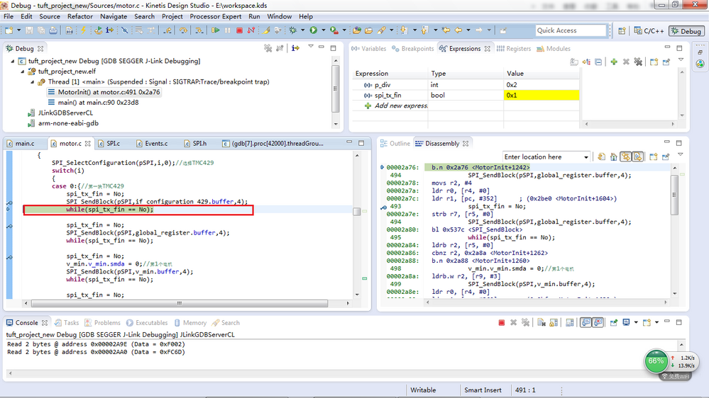

Unfortunately, when debug program, the progress was blocked here while(spi_tx_fin == No); I checked the debug progress and was sure in the event function void SPI_OnBlockSent(LDD_TUserData *UserDataPtr) the variable spi_tx_fin was set Yes
By the way, I offer my project to you. Thank you!
Above picture is about the build optimization level -Os, it is that debug progress was blocked here while(spi_tx_fin == No);
Now, the below picture is about the build optimization level None(-O0), it is that debug progress was ok sometime.

In my project, I have enabled the interrupt. Also, I have saw the debug progress run in the interrupt function PE_ISR(SPI_Interrupt), and sure the function void SPI_OnBlockSent(LDD_TUserData *UserDataPtr) was called from the interrupt function. I was confused that the debug progress blocked in the interrupt when the project build optimization level was set -Os and it seemed the program thread not return and blocked on the line: while(spi_tx_fin == No);. How ever, the program thread could return from the interrupt when the build optimization level was set -None(-O0) and not blocked on the line:while(spi_tx_fin == No). I hope you can download the project I provided and test it.

I am not quite sure about this behavior but maybe this could be reason. You can try using a volatile variable for the callback flags.
In events.c declare:
volatile uint8_t spi_tx_fin = 0;
In main.c declare it as external:
extern volatile uint8_t spi_tx_fin;
