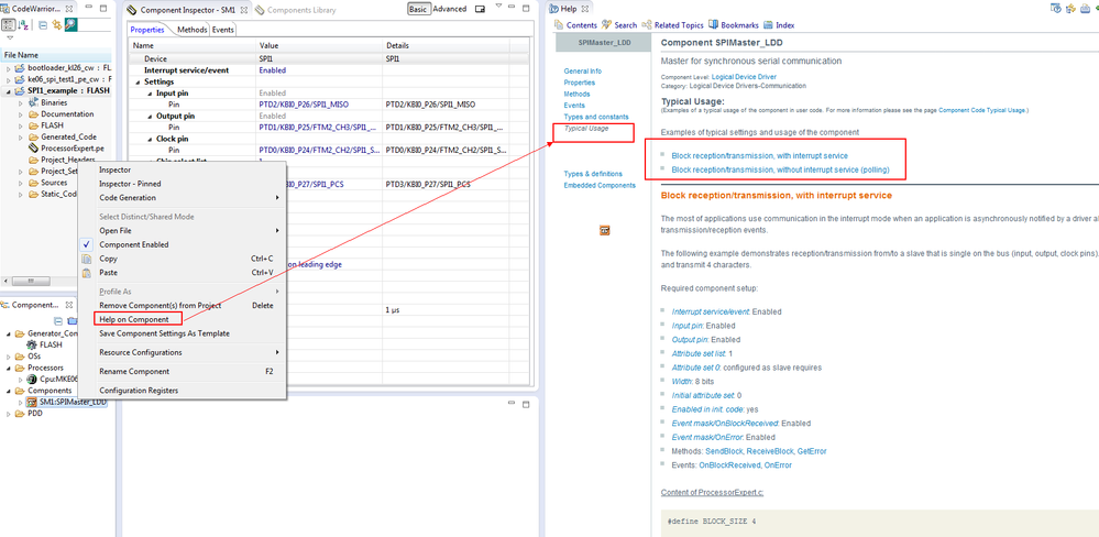

I have installed KDS version 3.0.0 on windows 7 along with Processor Expert .
My Queries are as below .
1. I have KDS version supported MQXLite and does its requires KSDK for MQXLite support ?
2. Any example / tutorial project which shows Task using MQXLite and Processor Expert components.
     E.g. : Task using lwevent (MQLite ) and UART ( PE Component )
3. What all we require to start MQXLite and PE based project on KDS IDE.
Thanks .
1 返信
598件の閲覧回数
Hello Anil,
1.It doesn't need KSDK .
2. The attachment is a MQXLITE training material , the  honds on is about CodeWarrior  demo , while it is the same on KDS , you can refer to .
And about the UART or ADC component usage, you can refer to the "Typical Usage" of Help on component :
3.  You only need the KDS , and the "Help on component" on PE is useful when you development  your project use the PE.
Hope it helps
