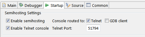

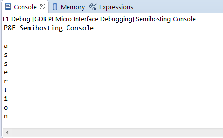

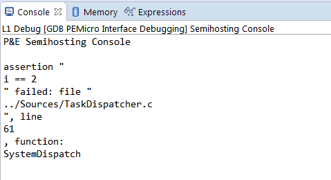

Someone know if following behaviour is a bug or a tool setup error; and a workaround or fix ?
The expected printout was "assertion....", in one line.
Tools : KDS 3.2.0, GCC, P&E Multilink Universal.

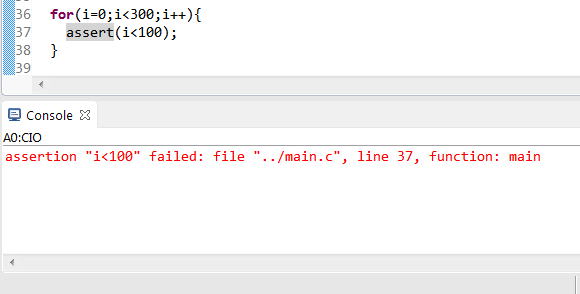

walter_gallegos
Only to confirm this as P&E issue,
We receive last week some J-LINK pods, so I experiment this morning.
Segger GDB work as expected; same target hardware and same firmware as in others tests.

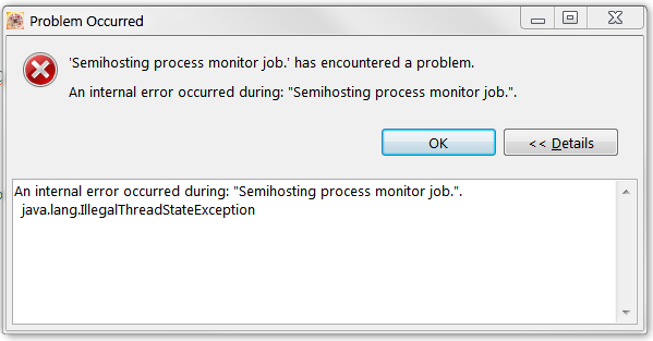

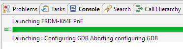

Unfortunately, switching to last stable version of ARM GCC libs I lost the semihosting service. The debugger hangs-up for long time and finally show an error message.
with GNU Tools for ARM Embedded Processors 5  - Q1 2016
After the internal error KDS and pegdbserver still running even after close KDS
Is necessary manually kill this process before run KDS again.
Back to default KDS 3.2.0 libs, the debugger back to work again. Maybe incompatibilities between versions ?

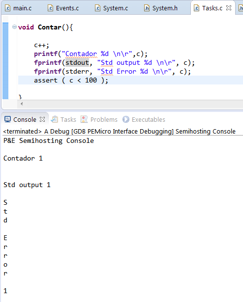

I have made some tests, and to me this indeed might be related to the stdio implementation in the ARM/Launchpad libraries.
I get a different result if not using the newlib nano (using the stdlib):
  printf("hello world!\r\n");
  fprintf(stdout, "Stdout output: %d\r\n", i);
  fprintf(stderr, "StdErr output: %d\r\n", i);
gives
hello world!
Stdout output: 0
StdErr output:
0
I'm puzzled by that newline for StdErr, but at least it looks better.
While with newlib nano I get same as you report:
hello world!
Stdout output: 0
S
t
d
E
r
r
o
u
t
p
u
t
0
I have not checked with newer ARM versions of the GNU libraries, but maybe using newlib gets you closer to what you need?

walter_gallegos
Hi Alice,

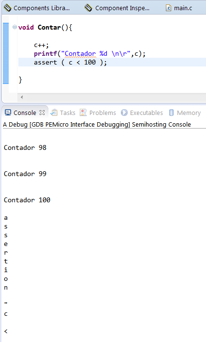

Look at screen captures, fprintf() function work as expected using stdout stream but not using stderr stream.
I think the problem could be related to the unbuffered default behaviour of stderr stream. Throw stderr stream, in some part of the process, was added a new line and a carriage return after each character.
I'm really surprised that no one else trap this issue. Nobody uses assert() to validate pre- and post-conditions ?

stdout and stderr have different behaviour.
Apparently stderr is treated as a character device.
Walter

Hello Alice,
The problem is "assert"; "printf" work as expected.

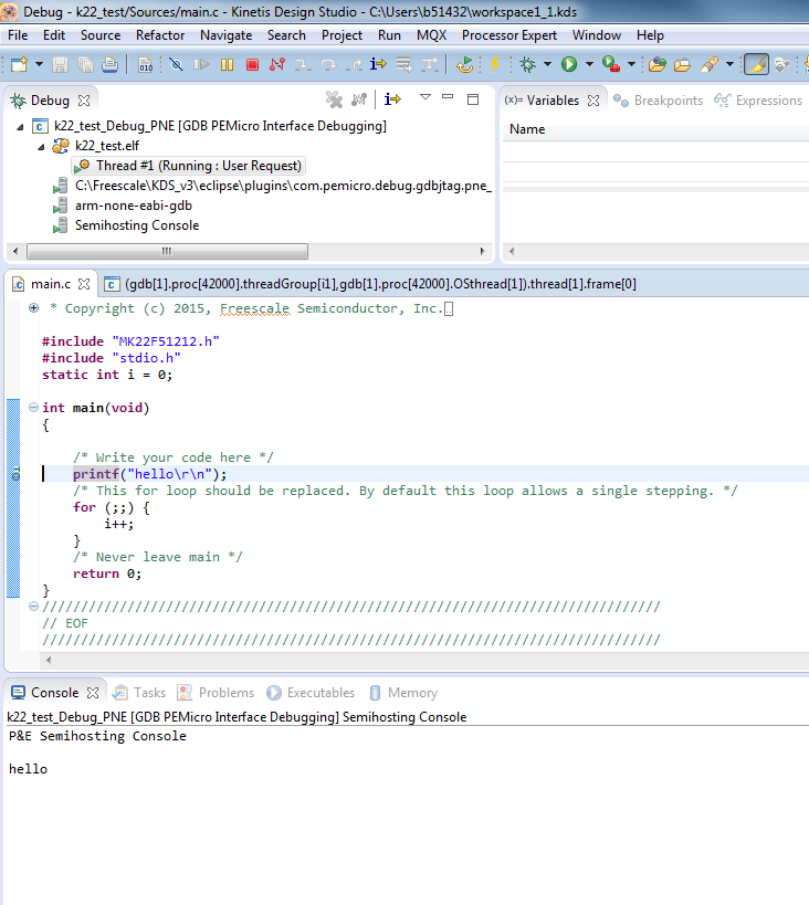

Hello Walter,
I test on simple printf project on KDS v3.2, it can work well.
And my configuration is the same with yours .
I see your project have printf some words, and what should it be , what about the right result ?
Alice
