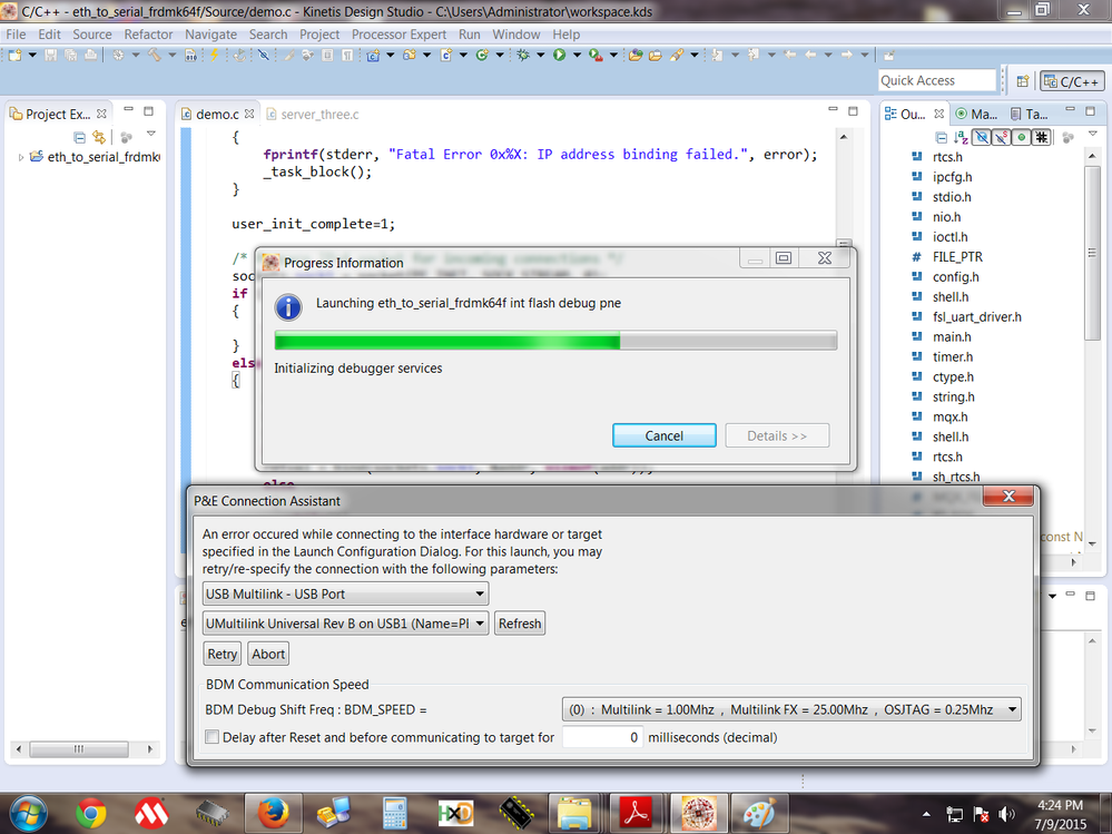

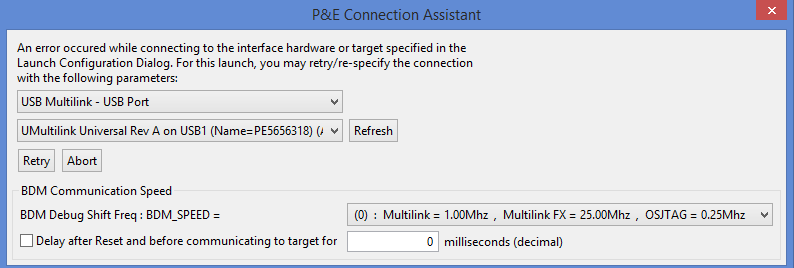

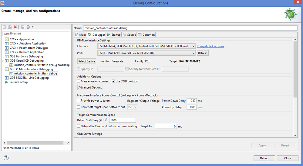

I'm trying to use a P&E USB Multilink Universal interface with my FRDM-K64F board.
I'm using the following debug configuration:
However, when I try to debug I get this:
Anyone run into this before or have an idea what the problem is?

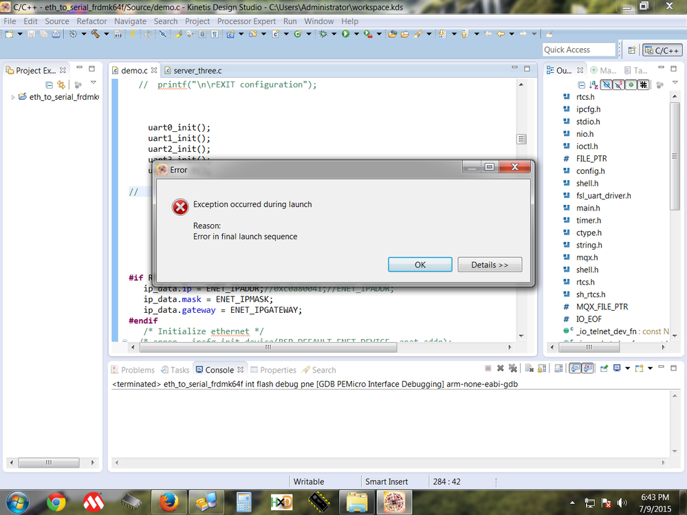

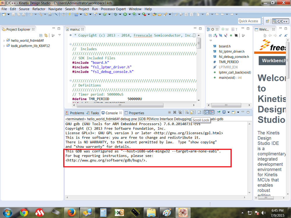

i tried with KDS 3.0.0 and KSDK1.2.0 i am not get any connect error problem error
actually I  CONNECTED  K64 USB(J22) PORT. AFTER THAT ONLY CONNECT ERROR PROBLEM SOLVED.
i loaded hello_world example code after i restarted board (USB unflug and flugged). but existing code only there. i dnt know why. in console i am getting following instruction,Untitled5.png
again i connected opensdav2 in my pc but hellow word code was not running. previously i loaded LED blink code throught OPENSDAv2 that code only running.

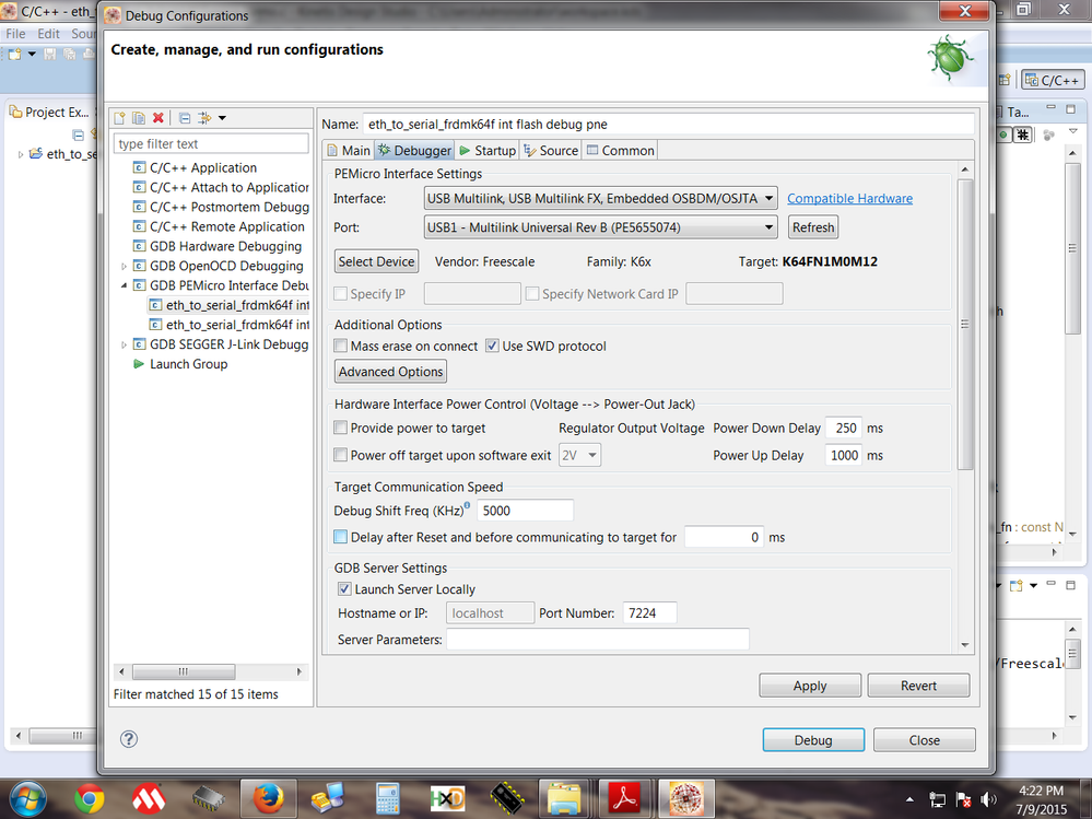

Hi David,
     me also have same problem. am using KDS2.0  and ksdk1.1.0. i am using MK64FN1MOVLL12 controller.
using help-> check for update option i updated my PE software. but still am getting problem. i added image also.Untitled1.png
after click Debug button am getting following error.
i tried with both OPENSDAv2 USB and also K64 USB but am getting same error.
5,707 Views
