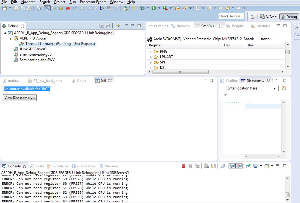

jqwang
Hi Erich,
i have the same problem:
i don't understand how to "Perform an assembly step" ?
Sometimes it shows "No source available for "0x0" ".
thanks,
JQ
