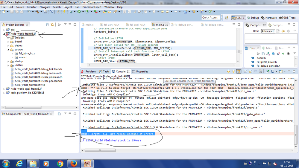

I am trying to build existing project which come with the KDS installation for k82 series.
Unfortunately I am unable to build the project because of getting error. I posted the error page here, there may be linking problem, but i am not able to fix it, please fix this issue.
I am using kds 3.0 and KSDK 1.3.0
2,712 Views
Carlos_Mendoza
Hi Surender,
Please make sure to first build the K82F platform library, it will generate the libksdk_platform.a library file mentioned in the error:
Hope it helps!

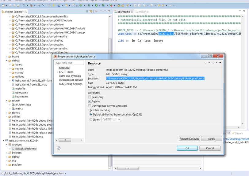

timcrockett
I just installed the IDE and had the same error. (Kinetis Design Studio Version: 3.2.0, KSDK 1.3.0). While trying to test my installation with the hello world demo for the KL26Z board I received the error:
"make: *** No rule to make target 'C:/Freescale/KSDK_1.3.0/examples/frdmkl26z/demo_apps/hello_world/kds/../../../../../lib/ksdk_platform_lib/kds/KL26Z4/debug/libksdk_platform.a', needed by 'hello_world_frdmkl26z.elf'.    hello_world_frdmkl26z"
I tried the earlier suggestion and still had the problem. I was able to find the path for the the missing libksdk_platform.a file in the platform project. I copied the path for the file by right clicking and Ctrl->C the path from the properties.
I replaced the problem path in the hello world object.mk file with the correct path. Note that you have to replace the '\' symbols from the windows path with '/' in the objects.mk path.
Built with no problems.

surenderreddyga
Hi Carlos Mendoza, Thnx
The problem is solved and got another one, here I am posting error page.
libksdk_platform.a file is created when compile the platform library, still showing error.
I think there may be linking is missing for arm-none-eabi-gcc, don't where it is?
Please help to get out of here..................

Carlos_Mendoza
Hi Surender,
Please make sure that when you import the projects into your workspace the "Copy projects into workspace" option is not selected, otherwise the include paths will point to the wrong location:
Could this be what is causing those errors?
Hope it helps!
