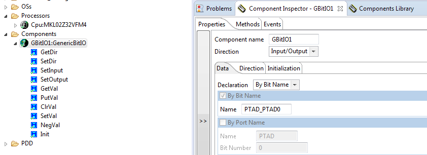

After you've added your IO component, you need to configure it in the Component Inspector like this:
Then in your C code, you can just drag in the methods shown below the IO component, like this:

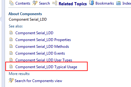

And on CW , there have the demo code on "Typical Usage" :

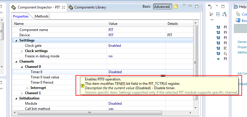

(2) On the view of KDS PE configuration ,  you can point to some selection , it will remainder you what's this  and show this will configure which register :
