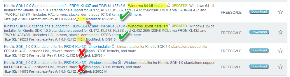

- Which installer for KL43 did you download? There is one which was released in September 2014 and a newer which was released last month. I would recommend installing the newer one. The link: Freescale Freedom Development Platform for Ki|Freescale
