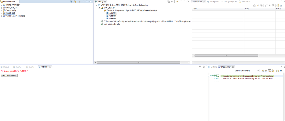

I am trying to debug a Processor expert code and below is the error message I am getting.
GNU gdb (GNU Tools for ARM Embedded Processors) 7.6.0.20140731-cvs
Copyright (C) 2013 Free Software Foundation, Inc.
License GPLv3+: GNU GPL version 3 or later <http://gnu.org/licenses/gpl.html>
This is free software: you are free to change and redistribute it.
There is NO WARRANTY, to the extent permitted by law.  Type "show copying"
and "show warranty" for details.
This GDB was configured as "--host=i686-w64-mingw32 --target=arm-none-eabi".
For bug reporting instructions, please see:
<http://www.gnu.org/software/gdb/bugs/>.
monitor preserve0 0
monitor selectcore 0
continue
Connection from "127.0.0.1" via 127.0.0.1
Copyright 2012 P&E Microcomputer Systems,Inc.
Command Line :C:\Freescale\KDS_v3\eclipse\plugins\com.pemicro.debug.gdbjtag.pne_2.3.6.201602211227\win32\pegdbserver_console -device=NXP_K2x_K22FX512M12 -startserver -singlesession -serverport=7224 -interface=USBMULTILINK -speed=5000 -port=USB1 -configfi

nakulyadur
Hi Alice,
Thanks for the quick reply.
My question is not regarding RESET SCRIPT, I am able to build and run the program. But when I debug, the program is receiving SIGTRAP and I am not able to debug the program. For your reference I am attaching the screenshot.
How can I get it to debug the program? Thanks.
regards,
Nakul

Hello Nakul,
Please test on simple project , check whether it can work well .
Alice
