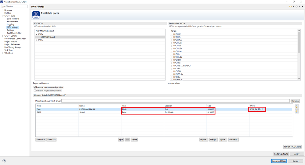

I am facing a problem that my code exceeds the plash size. Since the microcontroller that i am working with have a d-flash. Is it possible to specify for the linker to move the m_text section to the d-flash instead of the p-flash. I will appreciate any help plz.

Hello Haggui Souhail‌,
You can span the memory usage using the MCU settings perspective.

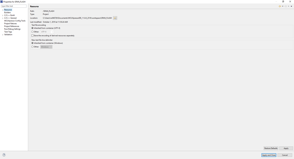

1. Select your project on your workspace.
2. Click on Project->Properties. The following view will be displayed:
3. Go to C/C++ Build->MCU Settings, configure the following fields:
4. Save the changes clicking on "Apply" and then "Apply and Close" button.
With the steps above, your project will be configured to make use of the entire Flash and RAM memories.
Best Regards.
Edgar.

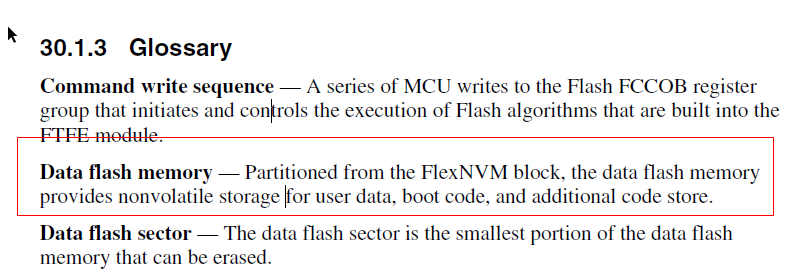

Hello Haggui Souhail,
Which product ?
If kenetis series,  yes. Please check reference manual of your chip:pastedImage_1.png
Hope it helps,
TIC

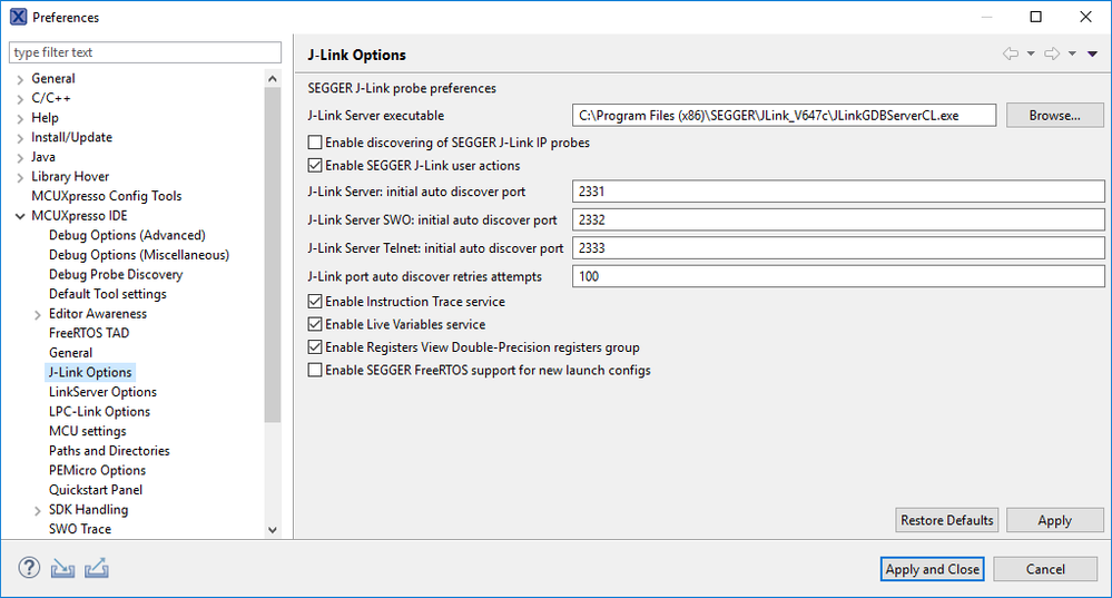

EdgarLomeli
Hello adargad@visteon.com‌,
The newest Segger J-Link release contains the proper support to program the FlexNVM memory address range.
1. Download and install the newest J-Link Software and Documentation Pack version (actually v6.52a).
2. Once you have installed the J-Link Pack, navigate to "Window->Preferences->MCUXpresso IDE->J-Link Options" perspective in MCUXpresso IDE.
3. Click on "Browse..." button next to "Search on the J-Link Server executable" and search the JLinkGDBServerCL.exe file from the newest version of J-Link. Save the changes clicking on "Apply" and "Apply and Close" button. At this point, you have updated the J-Link version that MCUXpresso uses to program the devices.
Regards.
