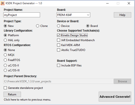

I'm using KDS version 3.0.0, KSDS 1.3.0: I've used KSDS project generator 1.0.
This is the screenshot about the generation:

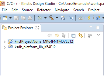

I've generated and imported in the kds studio. I've imported also the project ksds_platform:lib_K64F12, as You can see in the next screenschot:

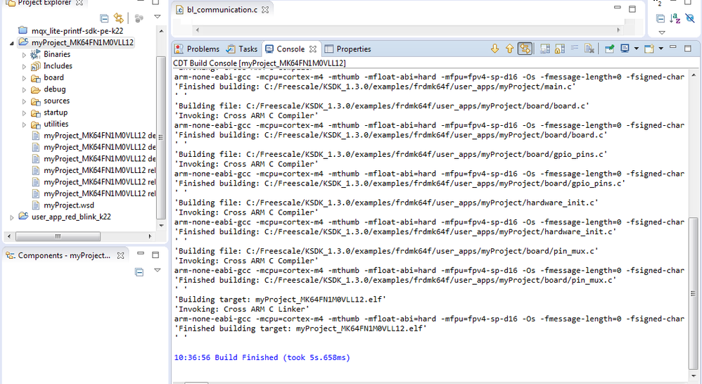

The error I get is:

Apparently, there is some issue with the file startup_MK64F12.s in your project. I have removed it, readded it from the folder C:\Freescale\KSDK_1.3.0\platform\devices\MK64F12\startup\gcc and now your project compiles without the warning.
I'm not sure about why that happened to your project. If you create another project and it happens again, please let me know the steps you've followed to create it and I will try to replicate and understand the issue.
