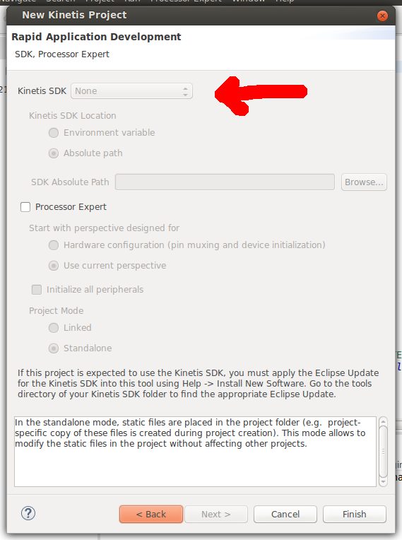

Well I was following the tutorial from (Writing my first KSDK1.2 Application in KDS3.0 - Hello World and Toggle LED with GPIO Interrupt ) on my Ubuntu 14.04 machine. Everything gone well, until I hit the "new project wizard". At the third "next" (I could name the project and select the board properly) I was not able to select the KSDK option in the combobox, as you can see in the picture below:
Is this normal? I suppose that is causing some misconfiguration in the new project, because I was not able to build it!

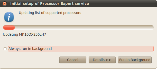

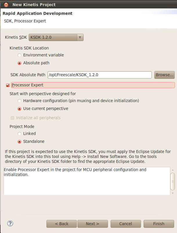

dave408
Senior Contributor II
Just out of curiosity, after installing the Eclipse Update, did you restart KDS and then see this dialog process a long list of processors?
I get the KSDK option just fine:

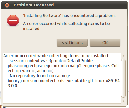

dave408
@Alice_Yang, FSL community support:
I'm trying to reproduce what Ronaldo has reported.  I have KDS 3.0 installed on Ubuntu 10.04.  I also have extracted KSDK 1.2 to /opt/Freescale.  When I try to install the archive via Help -> Install New Software -> Archive, I get this error
Can you please help me resolve this error?
3,616件の閲覧回数
dave408
Never mind, I figured out my dumb mistake.  :smileywink:

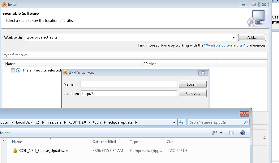

dave408
Ronaldo, to expand upon what Alice is saying, you just need to go here:
Then click Add -> Archive -> go to the eclipse_update path shown below and install the zip file
Then click OK and continue to install the update.  After that you should be okay.

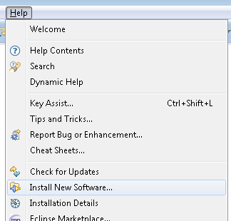

Hello Ronaldo,
Have you do this step :
And you use which chip ?
