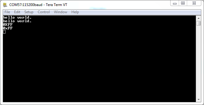

Carlos_Mendoza
Hi Christie,
I would recommend you to compare the project properties of your new project with the properties of the hello_world demo, I have done some test and I'm able to use both PRINTF and printf functions.
Regarding the formatting you mention, in order to print hexadecimal numbers using the PRINTF function you need to use the following syntax:
    PRINTF("0x%02X\r\n",255);
Here is an example based on the hello_world demo:
int main(void)
    char ch;
    /* Init board hardware. */
    BOARD_InitPins();
    BOARD_BootClockRUN();
    BOARD_InitDebugConsole();
    PRINTF("hello world.\r\n");
    printf("hello world.\r\n");
    printf("%#02X\r\n",255);
    while (1)
        ch = GETCHAR();
        PUTCHAR(ch);
You can check the chapter "12.1.2 Advanced Feature" in the Kinetis SDK v.2.0 API Reference Manual for more information on how to scan and print formatted data.
