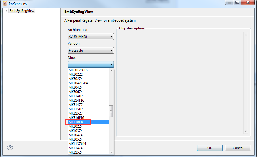

Currently I make the sample code our products using KE18F and I'm debugging now.
But I cannot find out KE18F of preference of EmbSysRegView to read and write peripheral registers of KE18F.
Could you please let us know how to access to KE18F peripheral registers in EmbSys registers window.

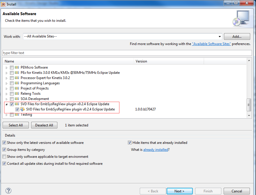

Hello Takashima,
Which version of KDS do you used ? I recommend you use the latest version KDSv3.2,
the EmbSys registers window has been integrated into KDSv3.2 .
And please install the update below :
Then we can view the register of KE18F:
Hope it helps
