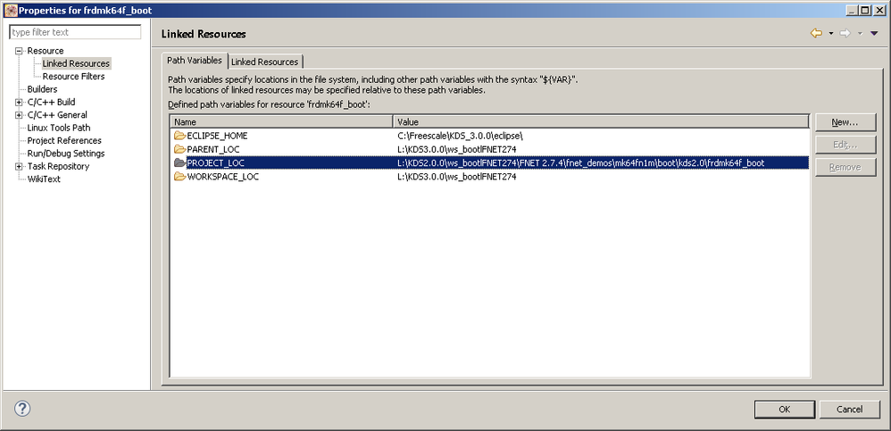

I imported a KDS2 project with KDS3 in a new workspace, my problem is with PROJECT_LOC, it's the old directory. see below
So, I tried to change the value of PROJECT_LOC, but I don't find a solution.
How to modify PROJECT_LOC?
Why KDS3 didn't change to the good project L:/KDS3.0.0/.... ?

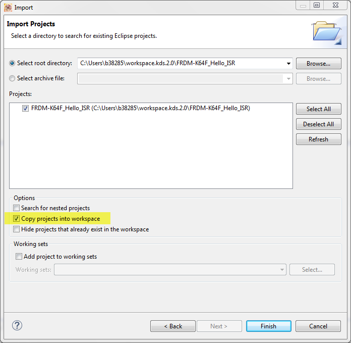

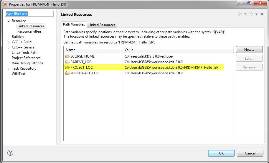

Hi Esteban,
When you imported the project did you selected the option "Copy projects into workspace"? if not, please try importing the project selecting this option, that way the project will be copied to your new workspace.
Hope it helps!
