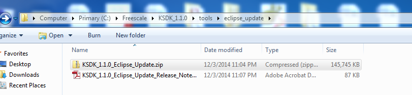

Hi Jorge,
Yes. I did updating. But, I didn't use *.zip file because there is no this file under KSDK1.1.0 and there are only jar files...
Christie

Hi Christie,
Does your KSDK directory like this :
If not , maybe the KSDK1.1.0 does not install successfully.

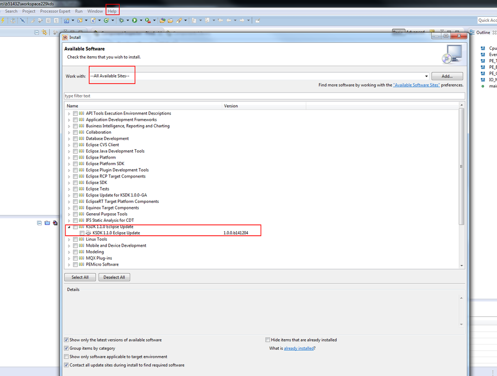

While it doesn't matter , you can also update KSDK online. please do as this :
Help-> Install New Software
then :
refer to the reminder to install it .
