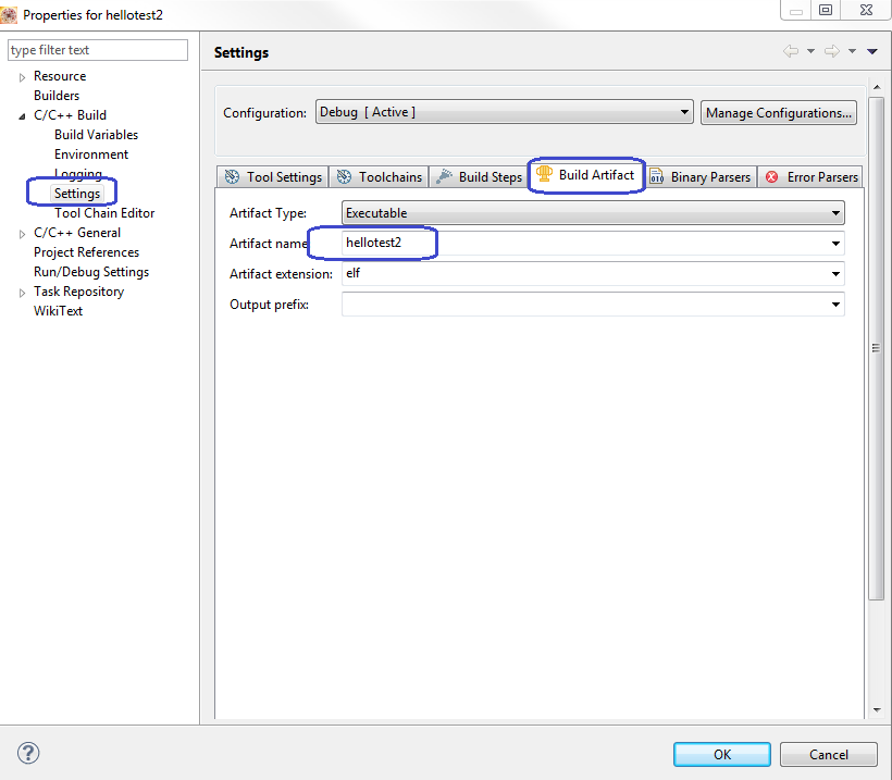

User also needs to change the ‘Artifact Name’ option after rename the project in order to generate ELF with new name. To do it, please:
1) Click on ‘Project’ Menu-> Properties
2) Click on C/C++Build > Settings
3) Click on ‘Build Artifact’ tab
4) Change the name in ‘Artifact name’, please see the attached screenshot.
