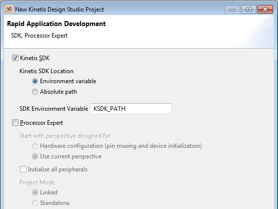

When creating a new KDS Project for the FRDM-K64F board, on the Rapid Application Development dialog, the Kinetis SDK selection is disabled.
With FRDM-K22F board selected, the Kinetis SDK selection is enabled.
Would this be expected?

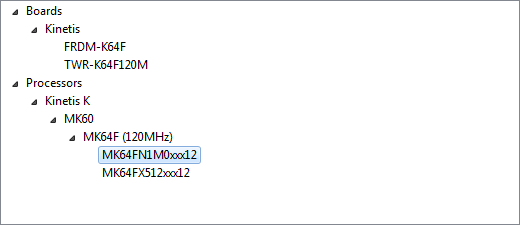

Hello Erich,
I've checked my Windows XP computer and the KDS with KSDK runs as expected.
The computer I'm having problem running KDS is Windows 7 Professional 64bit machine.
I have uninstalled KDS and KSDK.
With only KDS v1.1.1 installed (no SDK)  two boards: FRDM-K64F and TWR-K64F120M are available under New project setup. Kinetis SDK is understandably disabled.
With SDK support added additional boards are available under New project: FRDM-K22F, TWR-K22F120M, and TWR-KV31F120M. The Kinetis SDK option is only available for the three newly added board. Looks like adding KSDK support to KDS ignores already recognized K64F boards.
Also, every time I install KDS on Windows 7 I have to delete a .lock from D:\Freescale\KDS_1.1.1\eclipse\p2\org.eclipse.equinox.p2.engine\profileRegistry\DefaultProfile.profile If the file is not deleted, KDS will complain about Denied Access to .lock file.
Can you confirm KDS with KSDK and FRDM-K64F board running properly on a Windows 7 Professional 64bit machine.
Piotr

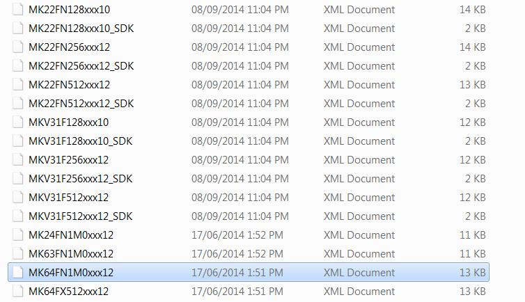

liborukropec
Hi Piotr,
could you please
1) send me this file eclipse\ProcessorExpert\Config\PE\CPE\wizard_data\wizards\driver_suite\MK64FN1M0xxx12.xml ? It can be problem with file premissions, that the file is not rewritten by the update. It seems only images can be placed here, use private message. Or paste here LAST TWO <condition> xml elements here so I can compare if the content is expected or not.
2) check in the "Console view" the messages from the Processor Expert and check the System directory if it matches the path the KDS is installed.
3) If you re-install KDS in the same location, please after uninstall delete the files in the install directory if there are any left. Especially the eclipse/p2/org.eclipse.equinox.p2.core/cache folder can cause very strange problems when installing updates into the "fresh" installation.
Thank you,
Libor

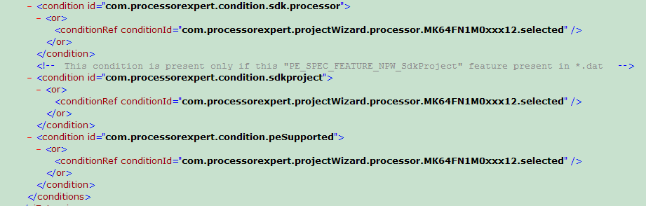

Hi Libor,
I checked my XP machine. Here are the last 3 <condition> elements from the file you asked about:
The middle <condition> is not in the file on my Windows 7 machine.
Piotr
3,824件の閲覧回数
liborukropec
Oops. I overlooked, sorry, the file content is not correct once the SDK supoprt is installed. It seems either the file was not overwritten properly, so it looks like file permission problem (in case you have installed the update from KSDK_1.0.0\tools\eclipse_update\SDK_1.0.0-GA_Update_for_Eclipse.zip).
When you synchronize the XP and Win7 in that directory - do you see any other differences? Also please compare "kds" folder located in the same place like the "driver_suite"
Libor

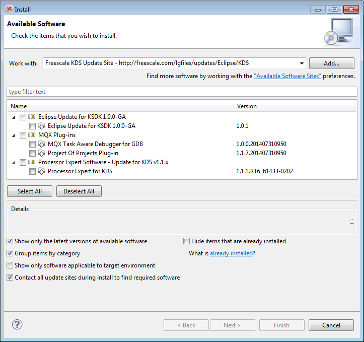

And looking and Installation Details I can see:
Eclipse Update for Freescale Kinetis SDK 1.0.0-GA
Version 1.0.1
I have downloaded it from freescale.com/ksdk.
What would be URL to access the KSDK's online repository?
Piotr
3,824件の閲覧回数
BlackNight
Hi Piotr,
The URL/update site is shown below, and is already listed in the 'Available Software' list (menu Help > Install new software).
http://freescale.com/lgfiles/updates/Eclipse/KDS

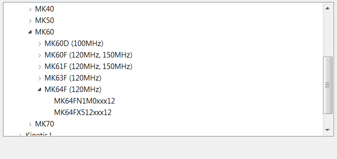

Hi Erich,

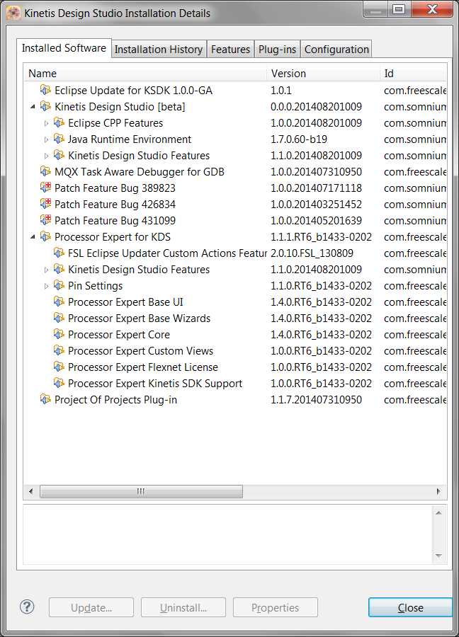

Here are mine Installation Details:
It seems that I have more boards and processors to choose from:
There is no problem with FRDM-K22F, TWR-K22F120M, and TWR-KV31F120M boards.
It seems that we are not running the same software (?). I have installed mine last week.

I can see an additional (missing before) item on the Installation Details dialog:
Will re-install the software on the first computer and see what happens.
