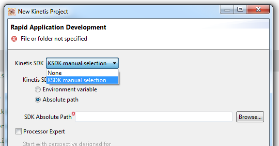

Recently, when I start a new Kinetis project and get to the Rapid Application Development page, it seems KDS has forgotten my KSDK path.
Instead of knowing that I have v1.2.0 installed, it shows me this. . .
Then I have to explicitly browse to the actual location.
How can I remind KDS where my KSDK is located?

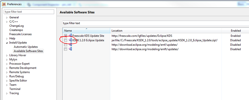

can you post the screenshot of the Eclipse - Preference - Update sites? Is the KSDK update ZIP registered there, or not? If yes, is the path valid? The NPW looks here to see all KSDKs installed.

BlackNight
what is the content of your KSDK environment variable?
And do you have the SDK v1.2 installed in
C:\Freescale\KSDK_1.2.0
It checks for that path, and if there is a ksdk_manifest.xml file there.

audi_mcavoy
Libor!  You got it.
My ZIP file was there; but it had been disabled.
I checked the box, restarted KDS, and it's fixed!
When I created a new project the RAD dialog automatically selected KSDK 1.2 with the correct path.
Erich, Libor, thank you both so much!
