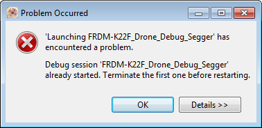

This actually is the case for the J-Link connection:
But so far P&E does not support such a thing yet. My hope is that an upcoming release could have this implemented too.
