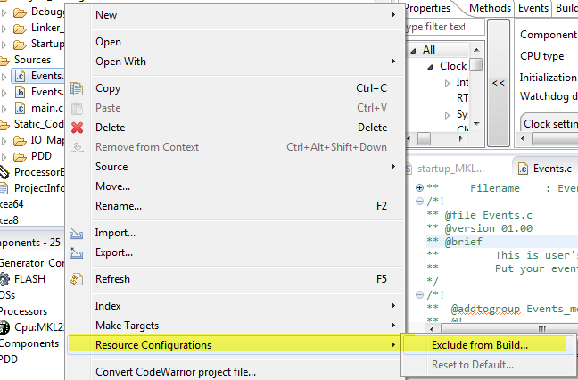

During  the developping FW, I don't want to to compile whole project. Just want to compile change, where the setting about the compile?

Hello kent,
I'm not sure if I understand your question. But if you do a build, then the build system only will compile/build the changed files, and not every file in the project.
Additionally, you can select one or more files and then use the context menu with 'Build Selected File(s)' to only build the selected files:

kentgu
Hi Erich,
Yes, my question is "if you do a build, then the build system only will compile/build the changed files, and not every file in the project.", how to realize the option?

Hi Kent,
The project does that automatically for you, it is called 'manged make'. Not sure if you are familiar with make files (Make my Make with Eclipse and MCU10 | MCU on Eclipse ). Basically the Eclipse project manager monitors the source files and adds them to the make files. The make files is processed by the make tool which then performs the necessary steps. The make file describes all the dependencies (e.g. which source file is including which header file). This gives the make tool the information to rebuild what has been changed. For example if a header file is newer, then the make knows which source files are using it and compiles those.

ZhangJennie
Hi Kent,
from my understanding. KDS doesn't have exact feature you need,
however user can choose to exclude a file from a project, thus this file is not included for build:
