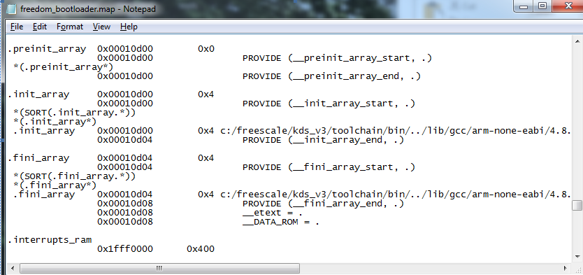

Hello Tilak,
How are you !
The reason is that the bootloader image size on debug build with KDS is over 0xA000. Here is example for FRDM-K64 debug build, this is the map file:
But with release build, the map file:
So there is two method,  one is please download the release version , then it can work well , i have test this.
The other one is change the "Target Address" , also need change the Application project address to the same ,
this one is complex than the first one , so i recommend you use the first method .
Hope it helps
Alice

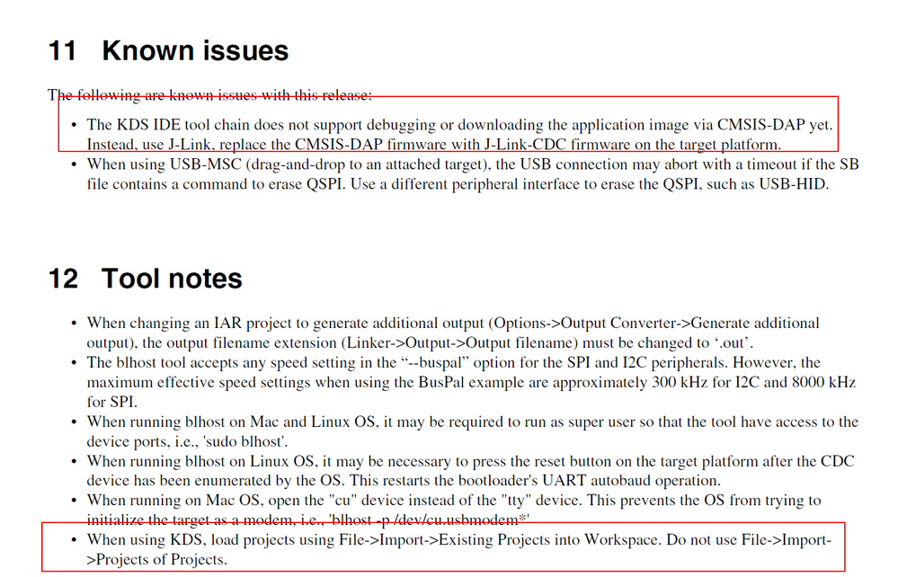

Hello  Tilak,
Please pay attention these two points:
( Kinetis Bootloader v2.0.0 Release Notes.pdf )
Hope it helps
Alice

tilaklakshmana
Dear Alice,
Thank you for the pointers to the release notes.
In section 11, I am using "drag and drop" via the debug USB port when it shows as a mBed mass storage device (E:\). This works for the IAR bootloader release binary, so I followed the same procedure for bootloader binary built using KDS. Does "drag and drop" also fall under this known issue that you have highlighted?
I do not have jlink connector specific for FRDM-K64F. However, I tried it on the board in which we are building with jlink. The IAR bootloader release binary and also the KDS compiled bootloader binary can be flashed. However, the flashing the led_demo via USB-HID does not work with KDS compiled binary. I believe the problem is not with debugging or downloading via KDS IDE but the binary compiled with KDS does not work.
In section 12, I follow the procedure as recommended, File->Import->General->Existing Projects into Workspace. I think this is okay.
Kindly let me know your thoughts on this.
Tilak

Hello Tilak,
How are you !
Hope it helps
Alice
