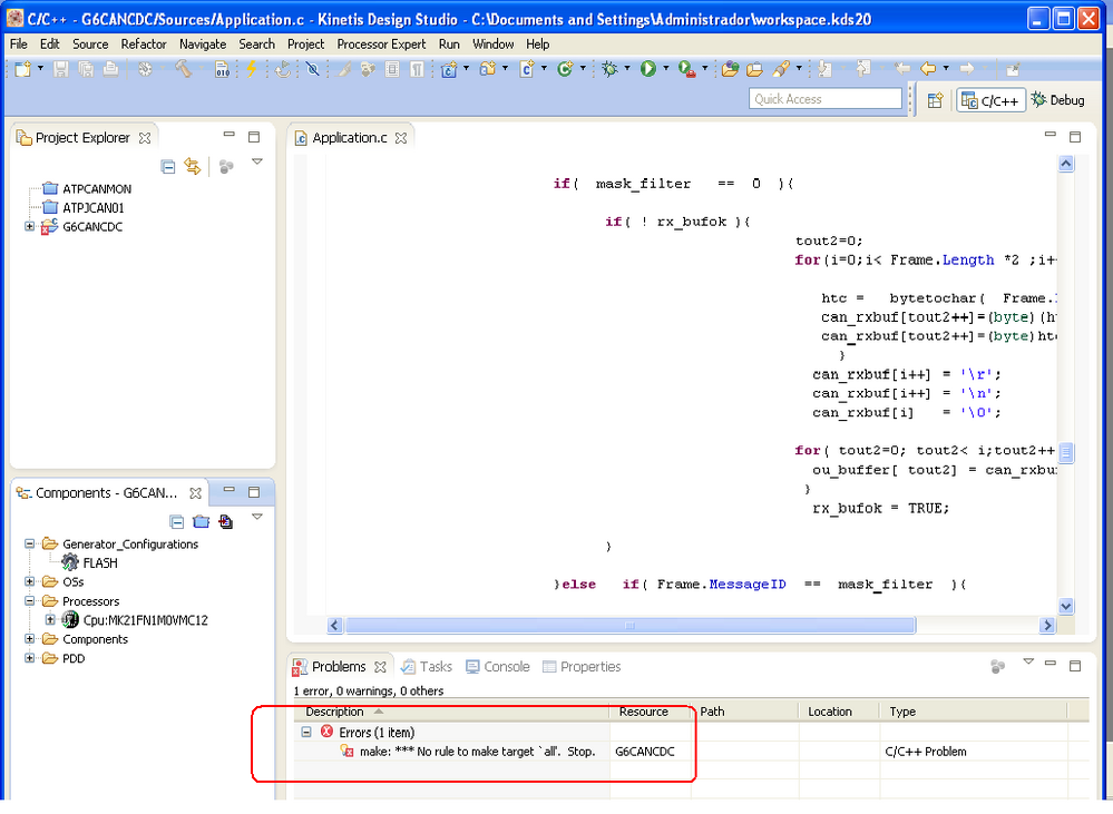

I have problems KDS V2.0, old and new projects.
old project:
how to re-builder old project,  in new kds?.
new project:
I use to compiler in PC, XP-SP3
thanks.

Hi Carlos,
I can build and compile your project without any problems. It seems to be a problem with your PC/environment.
However, Windows XP is not on the supported list of operating systems, so have you tried it on a Windows 7 machine too?
Erich

CCandido
Contributor V
Hi Erich,
I tested in Win8 = ok
thanks,
Carlos.

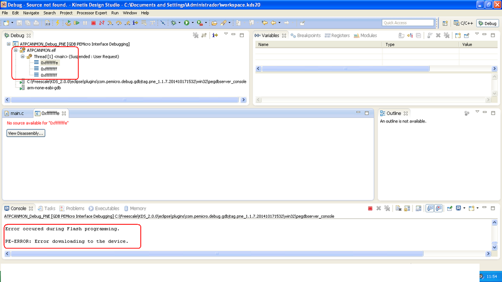

I use XP-Sp3,
using ( FLASH FILE  to Target ) in ( CW10.5 ) see:
Using restricted address range 0x10000000 to 0x1001FFFF
Programming file C:\Documents and Settings\Administrador\workspace.kds20\ATPCANMON\Debug\ATPCANMON.elf
Auto-detection is successful.
  File is of type Elf Format.
0 Bytes Programmed, Check Restricted Address Range
Program Command Succeeded
-------------------programming ok
KDS2.0: PROGRAMMING
CMD>RE
Initializing.
Target has been RESET and is active.
CMD>CM C:\Freescale\KDS_2.0.0\eclipse\plugins\com.pemicro.debug.gdbjtag.pne_1.1.8.201411191655\win32\gdi\P&E\k22fx512m12_pflash_dflash_eeprom_pipeline.arp
Initializing.
Cannot enter background mode. Check connections.
Error loading programming algorithm - load aborted.
Error occured during Flash programming. not programmer and debug.
PE-ERROR: Error downloading to the device.
new compiling = ok, programmer not.
project old :
DescriptionResourcePathLocationType
make: *** No rule to make target `all'.  Stop.G6CANCDCC/C++ Problem
