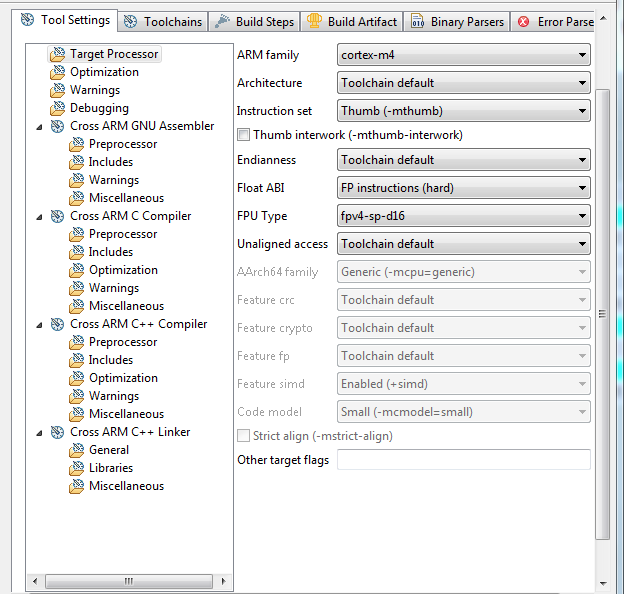

so I've ported a project off CW10.5 onto KDS V1.1 and got it to compile.  Debugging is another thing.
The following code is exploding on a hard fault interrupt:
double test = atof("1.2345");
if I do this:
double test = 54.321;
test = atof("12.345");
it explodes in the atof call inside something called _strtod_r()... test is showing actually as 54.321 (or close to it) indicating that there is some actual floating point going on.
When it explodes in this routine it appears to be on
vpush {d8}
I'm missing some sort of setting on this project now?  Is this library a bit wonky?  does this thing not understand floating point?  Is there some setting in the CPU that PE is missing that tells this it actually should use floating point hardware?
Target processor settings appear reasonable:

BlackNight
Hi Randy,
yes, the libraries are different in KDS. Are you using newlib or newlib-nano?
For my tests I created a project with the wizard and used the default (newlib-nano).
But if you have ported a project, you might be still linking against the CW libraries?
Maybe this is the issue?
Erich

randylee
Contributor V
Sorry to take so long getting back. Unwinding the stack and got a time slice for this particular issue.
I have found that the conversion tools don't work for me at all so what I did was to create the project with the right CPU in KDS then export PE from CW10.5 and import them here and then add the source files.  A little editing and things fell into place.
the link line goes: -T "C:\D\LC\Cyclops.kiln\Helmet.kiln\L22Helm.KDS/Project_Settings/Linker_Files/ProcessorExpert.ld" -Xlinker --gc-sections -L"C:\D\LC\Cyclops.kiln\Helmet.kiln\L22Helm.KDS/Project_Settings/Linker_Files" -Wl,-Map,"K22Helm.map" -nanolibc
This thing is on a K22FN1M0 so this thing is supposed to have floating point instructions in it.  Blowing up on running those is strange unless you can turn off the FPU and this isn't turning it on correctly.

BlackNight
Floating point unit/instructions are disabled at reset:
http://infocenter.arm.com/help/index.jsp?topic=/com.arm.doc.dui0553a/BEHBJHIG.html
So you have to enable it somehow (e.g. in the startup code). Below is an example how I do it with GNU gcc:
