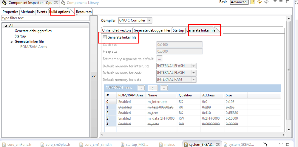

Hello Group!
I like using the Processor Expert and would like to know if there is a way to tell PE not to include the m_cfmprotrom sections when creating the linker file? Currently, I'm deleting these sections and managing the linker file manually. I have a boot-loader that manages the m_cfmprotrom section already.

Hello Monte,
It seems that the section of m_cfmprotrom is generate by default , and it can not control through  PE.
While you can do like this : configure the linker file by manually , then uncheck the "Generate linker file" :
then the linker file will not changed by the PE, and you can configure the linker file according to your peresonal willingness.

ocmonte
Hi Alice!
Yes, that exactly what I'm doing; managing the linker file manually. I just wanted to know if there was a way to disable that from PE. Looks like there is not so I'll continue to manage the linker files.
Thanks for the help.
