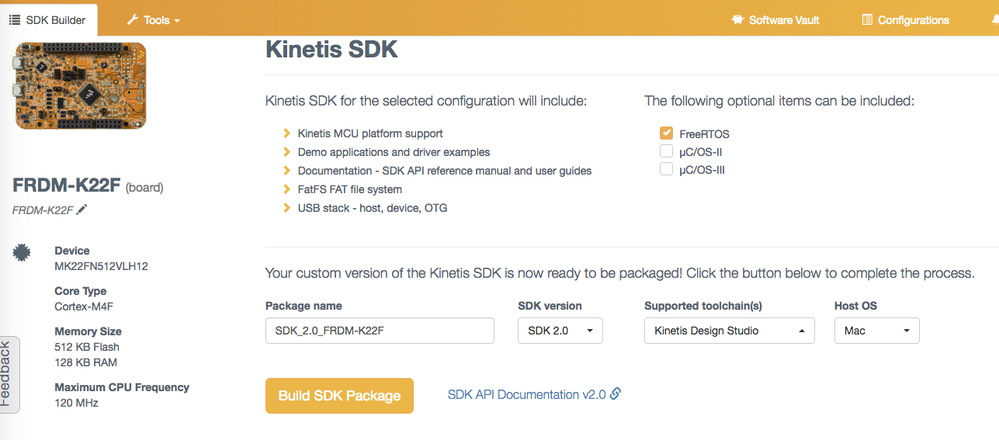

I ever downloaded SDK_2.0_FRDM-K22F package from
Welcome to Kinetis Expert | Kinetis Expert
but it only support iar, not for KDS. Did you revise it to support KDS?
to work with K22F with KDS, I use SDK_2.0_TWR-K22F120M. I attach my testing video here.

Well it works just fine with projects that are imported.  But not for projects that are created *new*.  But why would it not work?  I didn't revise anything.  I don't understand what you are saying about not supporting KDS... I can totally build for KDS and that is exactly what I did... see the attached picture.Screen Shot 2016-05-25 at 12.19.17 PM.png

thanks. I redownload the full version SDK_2.0_FRDM-K22F and test it again.
create a new project based on SDK_2.0_FRDM-K22F, it also works fine. see attached video,
I suggest you create a new workspace to perform the new test. do menu "project", "clean..." before build.
make sure you have all your update installed to KDS3.2.

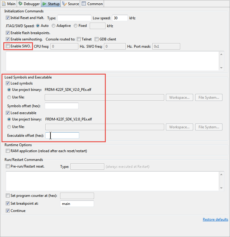

The warning about SWO is because you have it enabled in the debug setttings (openSDA does not support SWO), so you should disable it:
Can you check if it loads the symbols and executable as above?
I hope this helps,
Erich
3,287 Views
aerodame
It doesn't seem to matter whether I have SDO checked or not as to whether the code loads successfully.  But thank you  for that tip.  If I disable SDO, then the (benign) error message goes away.
