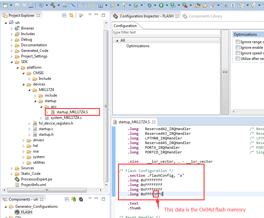

For what I see KDS (using Processor Expert/SDK 1.3), compiles for the entire flash image, including flash configuration field and everything.
After compiling, the flash configuration field ends as "FF FF FF FF FF FF FF FF FF FF FF FF FE 3F FF FF". I opened the resulting .bin in a hex editor to retrieve this. "3F" being the FTFA_FOPT definitions.
In the project I edit the fsl_clock_manager component and set Core Clock Prescaler to 2, that's the value of OUTDIV1.
After hitting "Generate Processor Expert Code" and "Build Project" int the resulting .bin file the configuration field is show exactly as before for LPBOOT bits, that's, the same 3F value.
Reading the user guide my understanding is that chip will always read FTFA_FOPT registers for the defined fields. I was expecting to see this change on the configuration field. Actually trying to understand how it works my question is: Why changes aren't being reflected? There's something/set that takes priority over the settings defined in the FOPT fields?

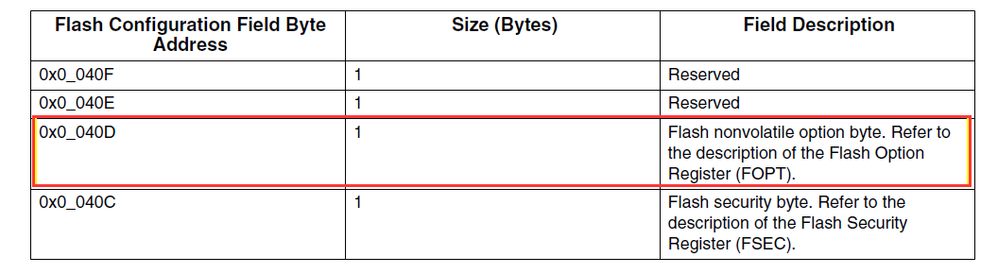

Hello ,
- Yes, the register of FTA_FOPT is read-only, which are loaded from
0x040D flash memory , please check the part of
41.3.1 Flash Configuration Field Description
on RM :
- If you want to change this register data , you need change the flash configure field data at the startup file :
Hope it helps
