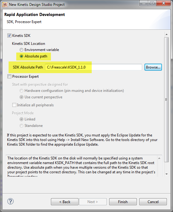

I am using KDS 2.0.0 and KSDK 1.1.0 on my FREEDOM K64F to develop my application. Everything works fine.
Now, BOOTLOADER V1.2 is using KDS 3.0.0.
1) I want to know if it is OK to use my environment for BOOTLOADER V1.2?
2) If I want to install KDS 3.0.0 and KSDK1.2.0 on my machine, can I keep both environments to work for the different project? If so, could you tell me the detailed procedure to install the new environment?

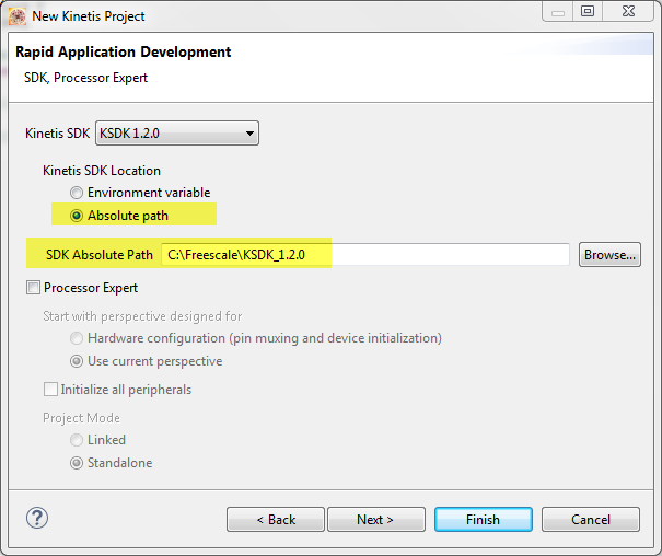

In addition to Alice's response, the Kinetis bootloader 1.2.0 was compiled and tested with Kinetis Design Studio v3.0.0, so I would recommend you to create a new environment in KDS 3.0.0 to work with KBOOT 1.2.
Regarding the installation of KDS 3.0.0 and KSDK1.2.0, you can have both versions of KDS and both versions of KDSK installed in the same machine without any problem, I would just recommend that you make sure that the correct version of KSDK is chosen when creating a new project:
For KDS 2.0.0.
For KDS 3.0.0.
