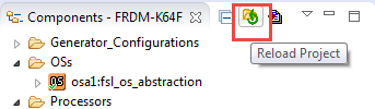

I imported a KDS 2.0 project into KDS3, and went through the upgrade assistant, but I get a message saying Processor Expert is not loaded.  Do I need to make a new Processor Expert project and apply all my existing settings?  That would be a little painful.
标签 (1)
5 回复数
1,109 次查看
BlackNight
No, all the settings should be in ProcessorExpert.pe file. You should be able to reload the project with that button:

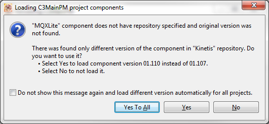

Thank you Erich, before I mess things up, this is the message I get:
1,109 次查看
BlackNight
Say 'yes' :-)
