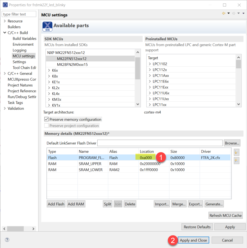

didierjeanjean
Thanks to Felipe Garcia for the good direction he give me to take.
I finally found all i need in MCUXpresso IDE with mcu-boot.
I run the example on frdm-K22F board an all is good;
Now i need to migrate my project to 0xa000 address to be load by  the bootloader
And i don't understand  why linker files exist only in boot loader examples like
frdmk22f_led_demo_freedom_0000.ld
frdmk22f_led_demo_freedom_a000.ld
frdmk22f_freedom_bootloader_0000.ld
In all another example the linker file don't exist ?
how can you compile this project ?
where can we modify linker information ?
how can i activate linker file necessary to parameter Flash address to 0xa000 address ?

FelipeGarcia
Hi Didier,
You can do that directly from MCUXpresso by doing the following:
Go to Properties > C/C++ Build > MCU settings
Hope it helps!

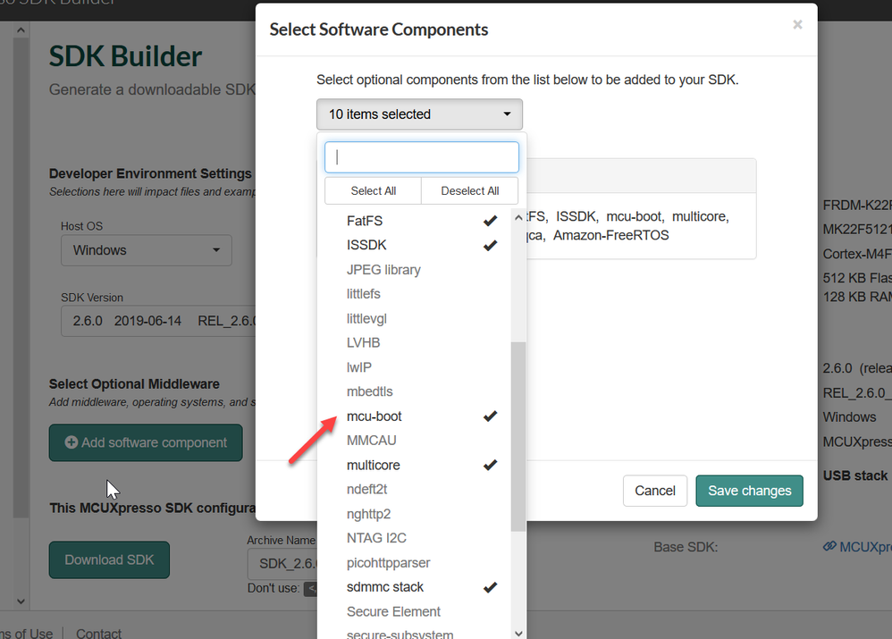

FelipeGarcia
Hello Didier,
KBOOT is the previous version of MCUBOOT and it is compatible with MCUXpresso. The recommended path is the following.
Download the corresponding SDK for your chip or development board. You can download it from the following link:
https://mcuxpresso.nxp.com/en/welcome
Make sure you select the mcu-boot middleware.
The corresponding files for your MCU will be located in your SDK package in middleware > mcu-boot.
Felipe

didierjeanjean
Hello and thank you very much Felipe Garcia
But you say first "KBOOT is the previous version of MCUBOOT and it is compatible with MCUXpresso"
and in the SDK you select "MCU-boot" that is different from "KBOOT" ?
do you mean :
1) that i must replace "MCU-boot" files by "KBOOT2.0.0" files  ?
or
2) "MCU-boot" is the same à KBOOT2.0.0"  ?
* Another question , I don't understand how we can have on the same application for complete IDE debug interface, bootloader and Application  on KDS3.2.0 ?  Can you give me the documentation where NXP explain how to make that ?
* Is it possible to compile bootloader alone on MCUXpresso or KDS3.2.0 then load binary bootloader on target, and after compile my application project alone on KDS 3.2.0 and load the binary application by UART bootloader  ?
* Is MCUXpresso SDK is the same or very different than SDK2.0 from KDS3.2.0 ?
Is transition of a complex project based on KDS3.2.0  with FREERTOS  to  MCUXtpresso with FREERTOS is easy because automated by MCUXpresso.
