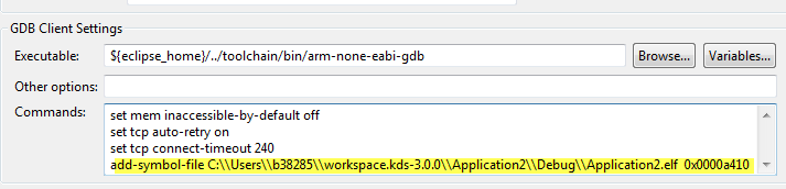

I am wondering if anyone has been able to set up a project(s) that allow you to build and debug both the kboot debugger and an application together, much like a library in KDS? I have a j-link debugger.
I have read all of the posts on merging projects but most seem cumbersome in that you manually have to include binary files from one project to another, and you can only debug one or the other.

Hi Terry,
You can use the following gdb command to load additional symbol files when debugging:
add-symbol-file filename address
Example:
add-symbol-file C:\\Users\\b38285\\workspace.kds\\Application2\\Debug\\Application2.elf  0x0000a410
0x0000a410 is the origin of the m_text section of my second application.

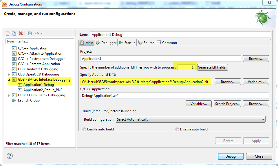

Please notice that you need to have both applications previously programmed, you can flash both of them selecting additional .elf files when using the P&E connection:
Or following the methods described on the documents you already mentioned.
