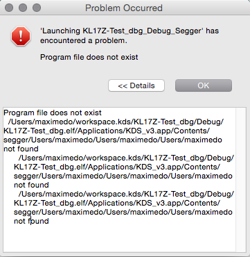

Even if already use KDS on a Windows virtual machine, I downloaded and installed KDSv3 for MacOS (I am still running Yosemite). IDE work, it compile and import SDKv2 also very well. But I (and this is why I am here )  cannot launch debugger with JLink because KDS return me errors :

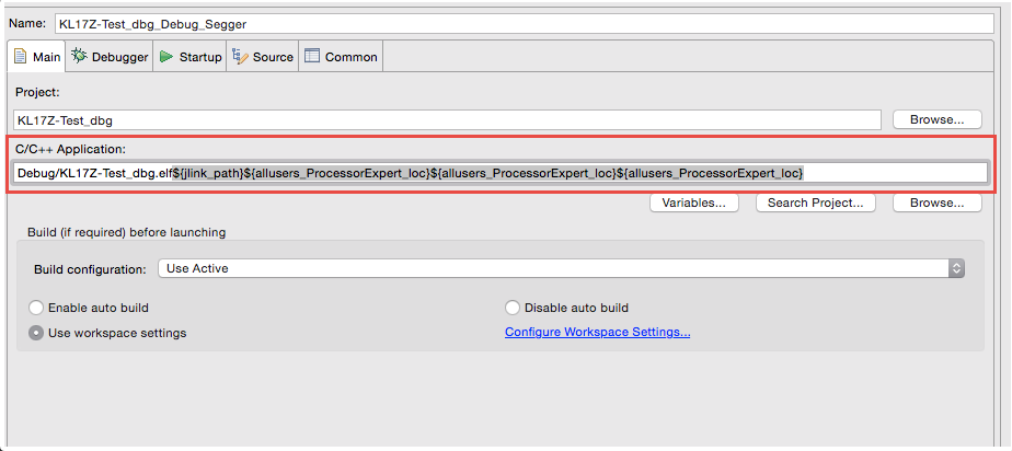

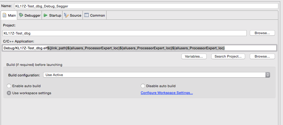

So I take a look in debug configuration and I noticed that C/C++ Application text box have other parameters set by default (see greyed part in the picture below) :
So I removed the greyed part but the Launching windows stuck at 99% of loading (see picture). I am using JLink EDU version.
After that, I have to force quit KDS even if I do a cancel request.

from the error message, the debugger doesn't find the program file.
in your project debug configuration. the application path definition is abnormal.
please refer my attached video of how to set project program file.
How it works?
if you still failed to connect, please create a new project with wizard, see if the new created project can be downloaded to flash successfully?
