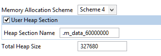

I have 512K of external memory (RAM) located at 0x6000000 and have instructed PE FRTOS to use that as its heap by defining a memory segment .m_data_60000000 in the linker file. This seems to work!
However when I try to increase the "Total Heap Size", the __copy_rom_sections_to_ram(void) function crashes. If I set the compiler optimization to Optimize for size (-Os) I can increase this number but never get to 512K. If the optimization is None (-O0), then I can only define about 128K to about 196K. I would like to make use of the full 512K.

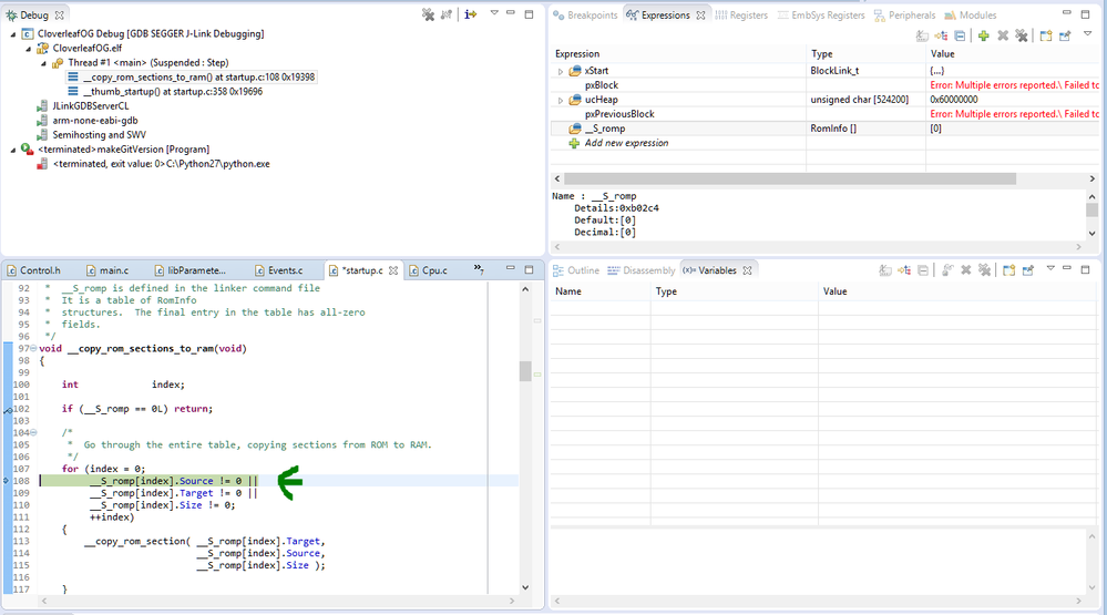

No, I don't think it is FreeRTOS as well. I did not to indicate that. It's crashing in the startup in the middle of the for statement in  __copy_rom_sections_to_ram(). When we enter the function, __S_romp is checked for zero then it proceeds to the for loop. It crashes (Cpu_Cpu_ivINT_Hard_Fault) where I indicated below (image too). Some notes: when I decrease the "Total heap size" to some point, it will start working. However, when you start to add more code that has initializers like strings, it will eventually crash. Decrease it a bit, and all is good until again more initializers.
Thanks for your help!
Monte---
void __copy_rom_sections_to_ram(void)
    int    index;
    if (__S_romp == 0L) return;
     * Go through the entire table, copying sections from ROM to RAM.
    for (index = 0;
         __S_romp[index].Source != 0 ||                <----- Here it crashes :smileydevil:
         __S_romp[index].Target != 0 ||
         __S_romp[index].Size != 0;
         ++index)
        __copy_rom_section( __S_romp[index].Target,
        __S_romp[index].Source,
        __S_romp[index].Size );

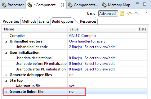

Yes, you can do this in the linker file. Define your own MEMORY section, then place the heap into that section (see how this is done in your current linker file).
As you use Processor Expert, you will need to disable linker file generation (otherwise your change might be overwritten).
See Disable my Code Generation | MCU on Eclipse
