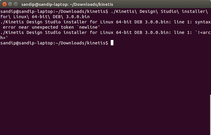

Hi all,
I have downloaded the KDS 3.0.0 installer for linux -- Kinetis Design Studio installer for Linux 64-bit DEB 3.0.0.bin.
My laptop is running Ubuntu 14.04.2 64 bit.
I have made the bin file executable first and then issued the command -- ./Kinetis\ Design\ Studio\ installer\ for\ Linux\ 64-bit\ DEB\ 3.0.0.bin in the terminal.
Then I get the following error --
Is there anyone for help/suggestions?
Thanks in advance.

You have to rename the .bin file to .deb, then just double click it to open the ubuntu software center to install it
529 Views
sandipkhara
Thanks. Your suggestion worked.

It will install the application in /opt. Go there in a terminal and as root do a chown for the whole directory. Something like
root$: chown -R sandip /Freescale
That will change all the files over to you and you won't have to run the KDS as root.
