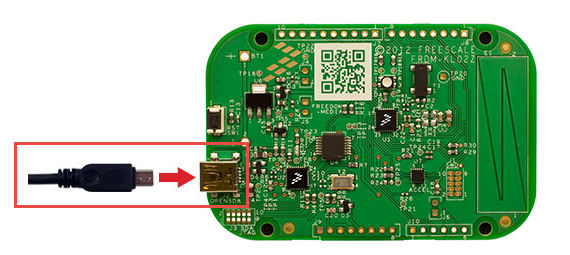

I'm unable to establish a connection to the target while running the debugger provided within the KDS. I'm trying to run 'hello_world_frdmkl02z debug jlink.launch. Do I need to be using the OPEN-SDA INTERFACE JTAG CONNECTOR (J3)?
Ive connected a Jlink to the SWD (J1) of the Freedom KL02Z and am still not able to establish connection using the debugger using the Kinetis Design Studio.

frdm-kl02z already integrated OpenSDA USB (J2) on board. why do you use SWD (J1) to debug ?
here is the video of how to get started with FRDM-KL02Z
Freedom Development Platform for Kinetis KL02|NXP
the default firmware of OpenSDA USB is P&E open SDA. in case it is corrupt, you can use attached MSD-DEBUG-FRDM-KL02Z_Pemicro_v114.SDA to have it update.
if you want to use J1 anyway, please make sure the connector is soldered well and also provide external power supply to the board meanwhile.

I was able to use J1 with the SEGGAR or IAR J-Link device. I didn't have a Pemicro device on hand.
I seem to have it working fine now!

- How to configure the debug configurations ? Please check the Device name :
And if still can not work well , please show the error .
- And you also can use the usb (j2) directly to connect and debug (need not use connect emulator), only need drag and drop the file of
"DEBUG-APP_v105_Pemicro.SDA" to the bootloader, then when debug select the "GDB PEMicro Interace Debugging".
